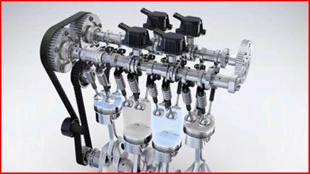

Oh. I really thought the new 150BHP version had ACT.
Not got my car yet to check, but someone with a MY16 could pop off their plastic engine cover and look to see if they have the 4 black units that control the ACT:
35
No ACT on the Octavia yet, only the Superb.
I think the ACT engines are in short supply. I was reading if you order a Seat Ibiza with the 1.4 ACT its about a 12 month wait at the moment.
I dont think they will launch it in the Octavia until the facelift next year.
