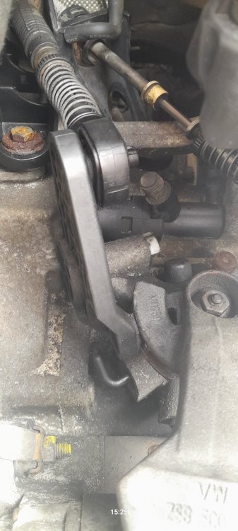

Hi @Warrior193 @BlueWagon .I took out the airfilter box and have a clear view of the linkage. The 1st and 2nd selector arm moves easily, but the reverse linkage (sideways movement) arm won't budge. It moves a millimetre. It looks like there is a solenoid under the armatage. Might this be locked closed when I changed the battery? I don't think there's any sideways movement available, only forward and backwards gear stick movement. I have a new battery but can't get to a garage to recode the battery because I can't get into reverse.

It can seize up and stop you selecting I think from memory reverse and 4th/5th. Make sure its moving freely. I snapped the one on my old Seat after it was sitting for about the same time. Also check the cast metal weighted lever as well is secure and hasnt come loose. If they are all fine and not seized then maybe reset the cables. Careful if removing the white plastic clips as they get brittle with age.

Hi Alasdair, this looks the same. How did you get it unseized? Or how do I reset the cable?
It normally seizes where the plastic spigot goes through the cast unit. I snapped mine by trying to force into gears so had to get a new one but reckon a good spray of penetrating oil and let soak followed by small careful movement it might free off. Worth a little grease afterwards. The small plastic clips as said are prone to get brittle and tend to snap if not very careful when removing. As for setting gear cables this a link to the process. Its on a fabia but the process is the same on most VAG group cars. Think its around 3mins in.

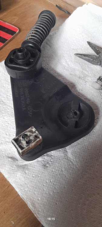

@Alasdair1 Thank you. You were right, where the plastic spigot goes through the metal casing was seized and I broke it too as I tried to get the car into reverse, it did go into reverse and I thought I'd solved it but then no gears, so I checked and the spigot had broken. The oil i used didn't get it free. The video was useful too btw.
Should the gbox selector locking pin be set verticle or horizontal? Horizontal allows the pillar to go up an down, so I guess that's correct.
Any tips on how to get the plastic spigot out of the metal cast hole? Can I remove the metal case unit with causing more issues, do you know?

Thats exactly what happened to mine. I repaired mine by drilling a hole in plastic where the spigot broke off and put a coach bolt in place. Drilled hole just slightly smaller than square on bolt and carefully tapped it home then used araldite to secure it and used a nylock nut and washer to secure it. Was supposed to be a temporary fix but its still on the car. Cant remember how I got the broken bit out. May have used a little heat and a punch to drive it out. If removing weighted cast arm it can only go back in one position. Think there is a flat section on splined spigot. Bolt I used looks like this. Careful if ordering a new plastic bit. I got one through autodoc but it was back to front so probably for a LHD car.

Great advice, thanks. I've ordered a replacement part, but your fix looks like a good option too. Thanks so much for your help!

@Alasdair1 I used a bolt as you suggested and got the car moving through all gears. Thanks for your help!
