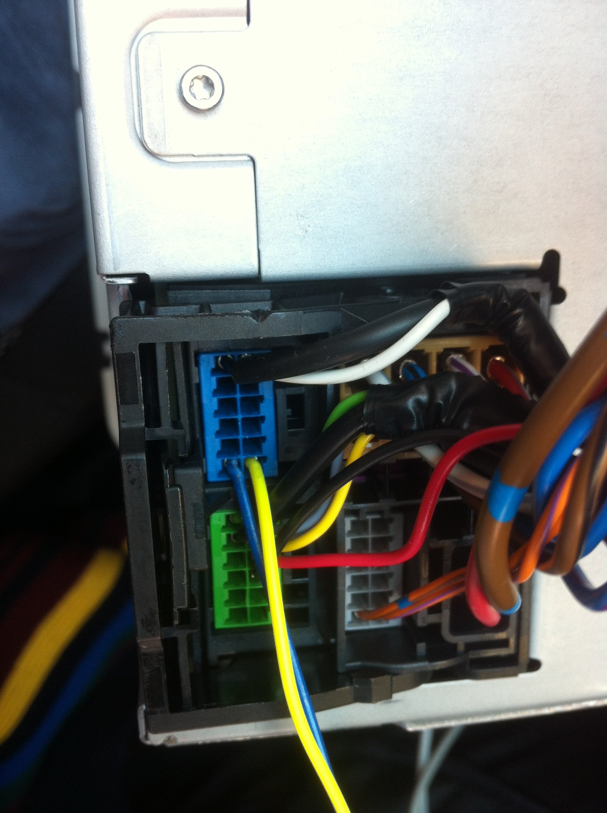

pab567 mentioned that the camera should be connected directly to blue connector pins 6 and 12.
My question then, which of these 2 connections are Positive and Negative?

First off was to get the Bolero Infotainment system prepared so with the radio removed  (trim surround and 4 screws)  I wired up a link on a Phono cable, plugged into the back of the radio.  The wires go into terminals 6 and 12 of the blue socket. I've used Blue and Yellow wires, those colours being available to me.
Thanks to PAB567, I learned that the connections are #6 Positive, #12 Negative (earth).

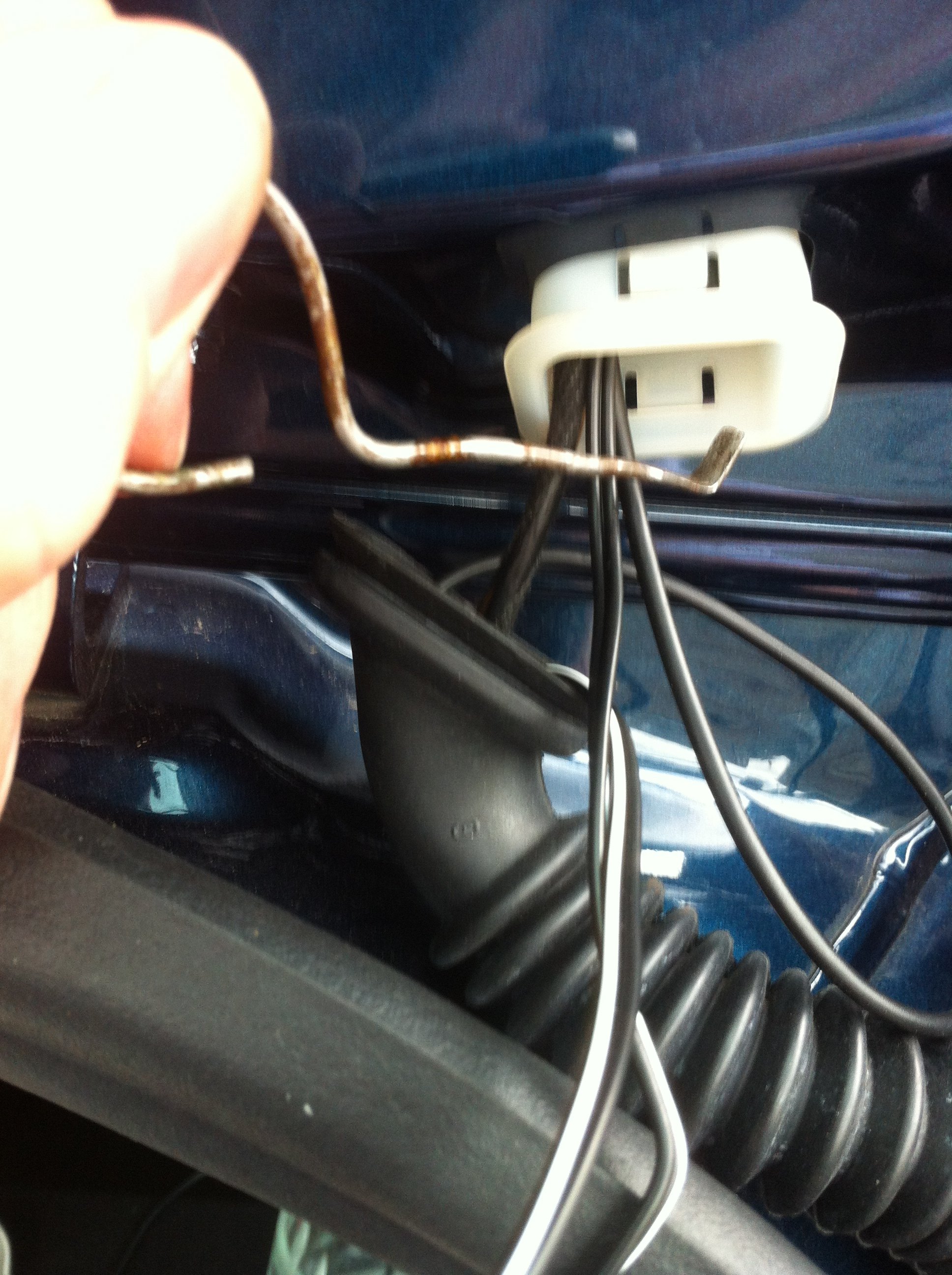

Wiring was next.  First off, the RHR tail lamp assembly was removed and the multi-plug disconnected.
Elephant's Trunk and Tailgate Wiring:
Don't worry or panic about the elephant's trunk, it's quite simple and works like this:
Gently peel the rubber trunk from both ends, it comes away rather like a grommet and exposes the plastic inserts at each end which engage in the holes in the bodywork.
With a tiny screwdriver or small wire hook with flattened end, release the holding catches and ease the inserts away from the apertures.
When replacing, refit the inserts into each end of the trunk rubber, then push/click back into the holes in the bodywork.  When you are doing some wiring, do remember to thread the wire through both inserts as well as the trunk!

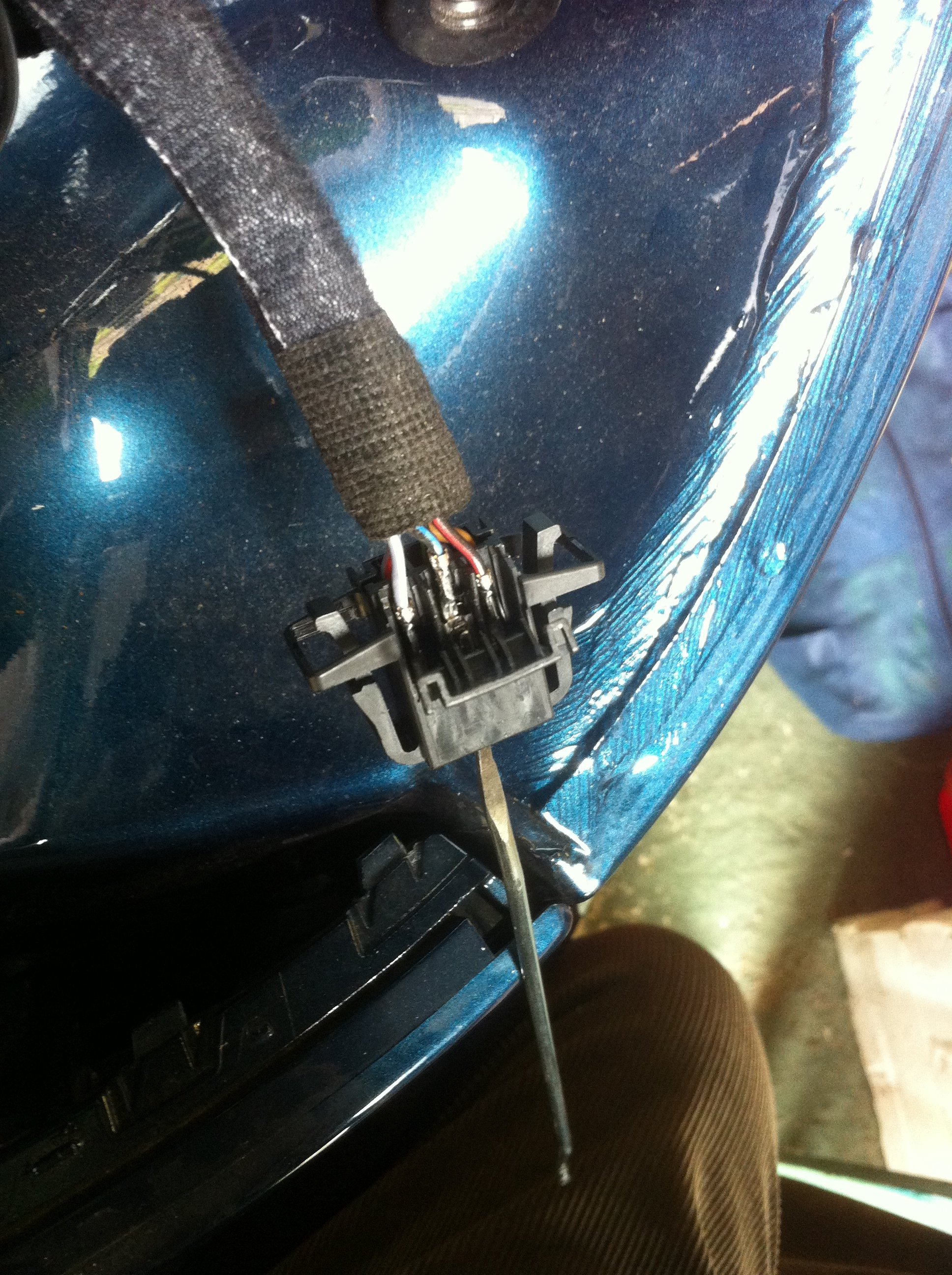

I had marked off the trim where I wanted to fix the camera before stripping down, so I screwed it into position on the inner face of the top trim and, with a small notch filed into the front edge (away from the glass) of the trim plastic, fed the wires through one of the slots close to the high-level brake lights.   Then through the elephants trunk and plastic inserts and down into the Right hand 'D' pillar (that's the rearmost one). A bit of fishing with the curtain wire between the top aperture and the tail lamp loom soon had the camera wires down the pillar, grabbed with the forceps and out into the tail lamp space.  So, we now had the power wire, earth and video feed available.  I had real trouble finding an earth point.  There are one or two screw heads visible but they must be into plastic nuts, as I couldn't get continuity. The obvious thing was to screw the earth direct to the body, behind the tail light inner housing. (Picture is further down).

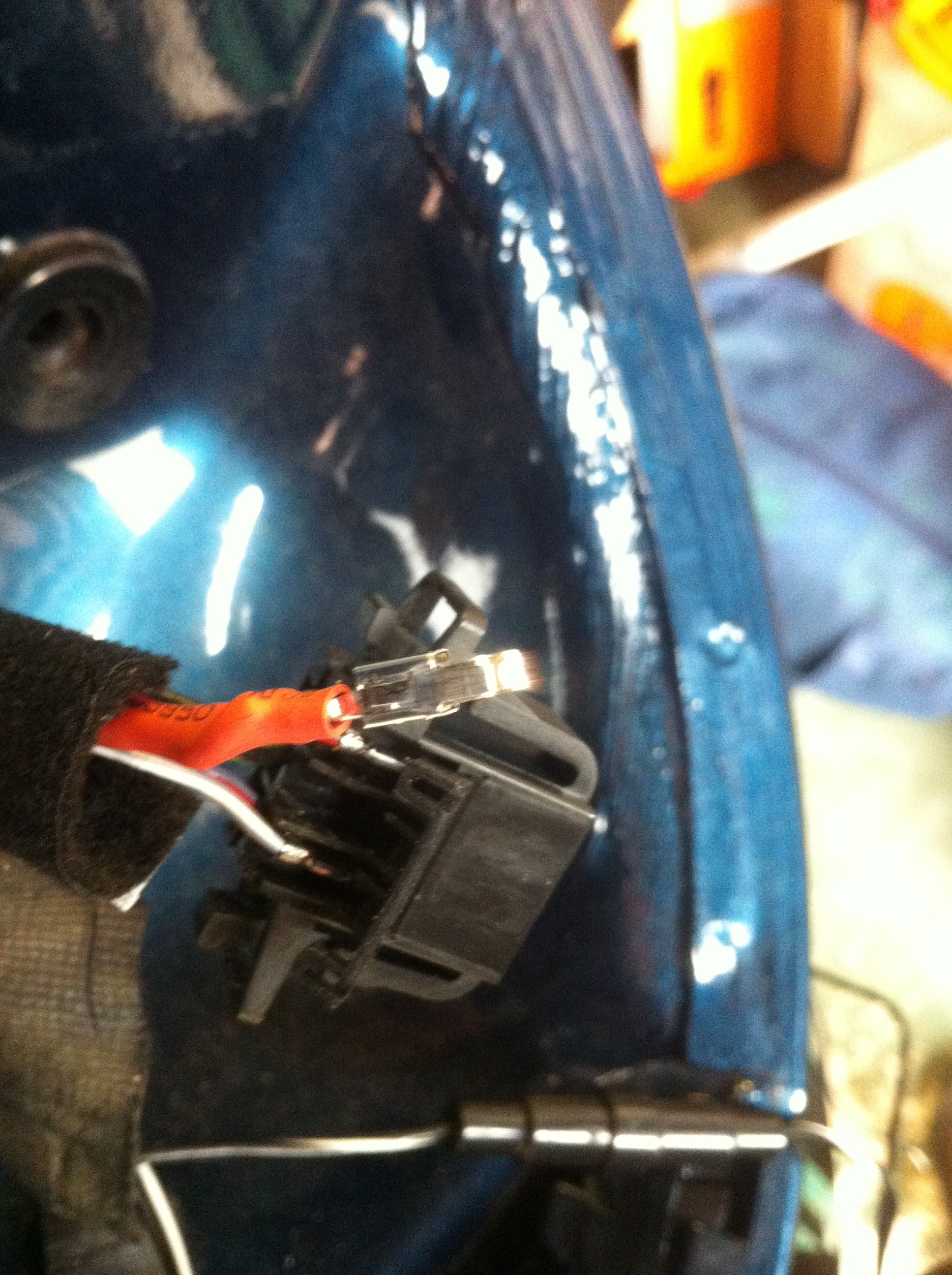

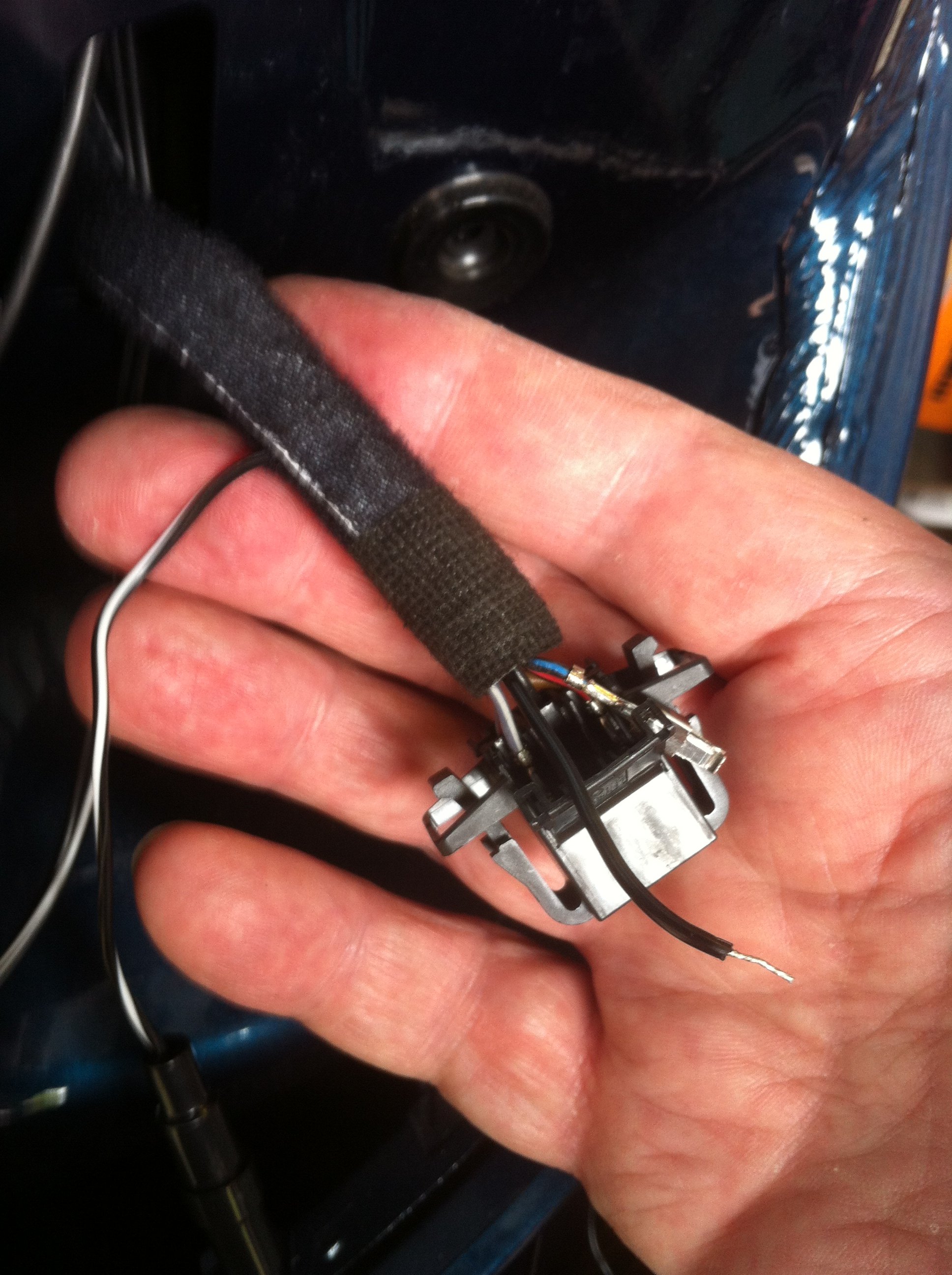

Next step was to provide a power supply for the camera. I tapped into the reverse lamp loom for this.  The reverse light supply terminal needs to be unlatched and removed from the terminal block with a Terminal Release Tool.  Mine was the Blue wire in the centre of three.
Edited by Clive1942
Part Four

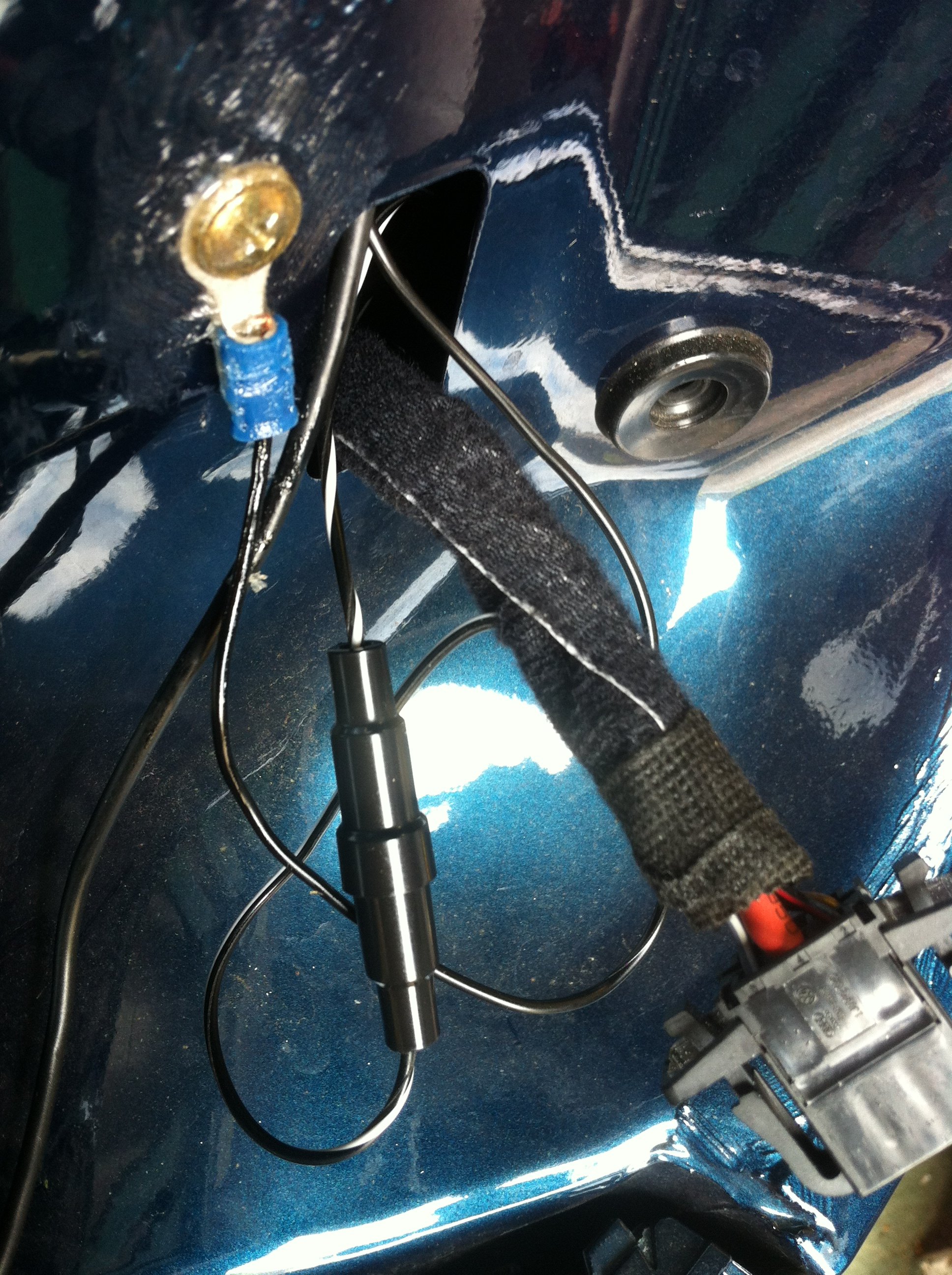

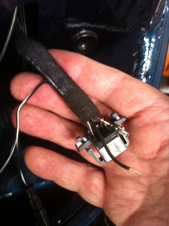

  Then the power lead was threaded into the loom wrapping, about 8cm from the end.
Edited by Clive1942
Part Five
The wrapping is textile so it's easy to make a small hole and feed in the wire.  I carefully unwrapped the loom cover and brought the new wire out to the terminal position.  Heat shrink tubing in place ready and a quick touch of solder of the Positive onto the wire end of the reverse lamp terminal.  The heat shrink was then pulled forward and heated and the terminal replaced in its block.  The top section of the terminal block opens up which helps access when pulling the terminal out and replacing after soldering the feed wire.
Part six
The earth was fitted with a ring terminal and attached to the body with a self tapping screw.  I positioned the screw close to the loom aperture so it sits inside the tail lamp inner seal area.  The terminal and screw were brushed with vaseline before installing.  I use vaseline because it's inert - no detergents or other fillers.  (It's the same when protecting battery terminals before connecting).  The continuity isn't affected because screwing the job together ensures metal to metal contact but any remaining vaseline keeps out moisture and helps prevent corrosion.
Edited by Clive1942

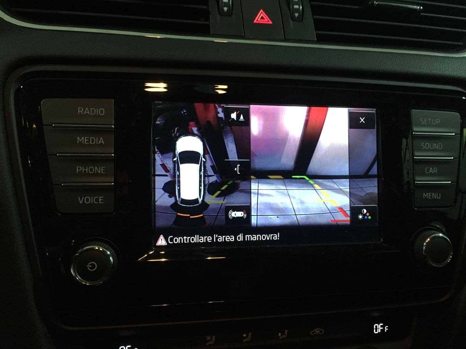

Very useful post!!! Thanks a lot...
I found another useful video to programming the system:
Installation and configuration video
Now I have a cam on my car B):biggrin:
Edited by turbo73
In attach a photo :thumbup:

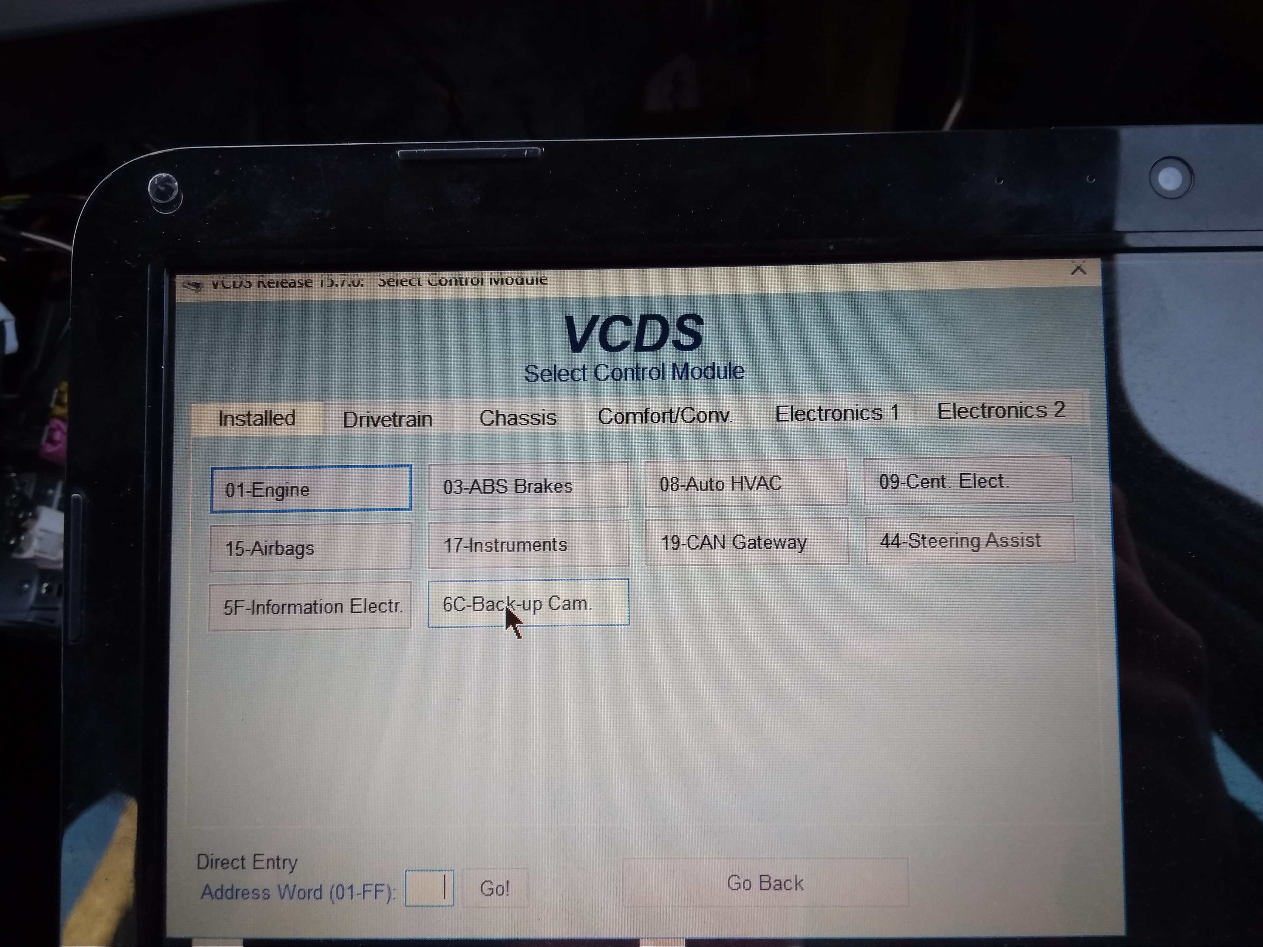

Well it seems impossible to activate the camera. I connected everything but it does not work. I installed the module 6c (rear view camera) in can gateway list but when I ty to access it it does not work. There is no way (that I know) to activate. I took a picture to show you what modules I have.
What can I do?
Hello Joao, The details you show look OK but I would emphasise that I had SJB at Basingstoke do the coding for me.
The only other thing that I can think of is to ask how you are powering the camera? The feed for the camera needs to come from the reversing light feed (which is alongside the tail light loom).
Alternatively try testing the installation with a jump lead from the cigar lighter to the camera to prove that it will work.
ATB  Clive
