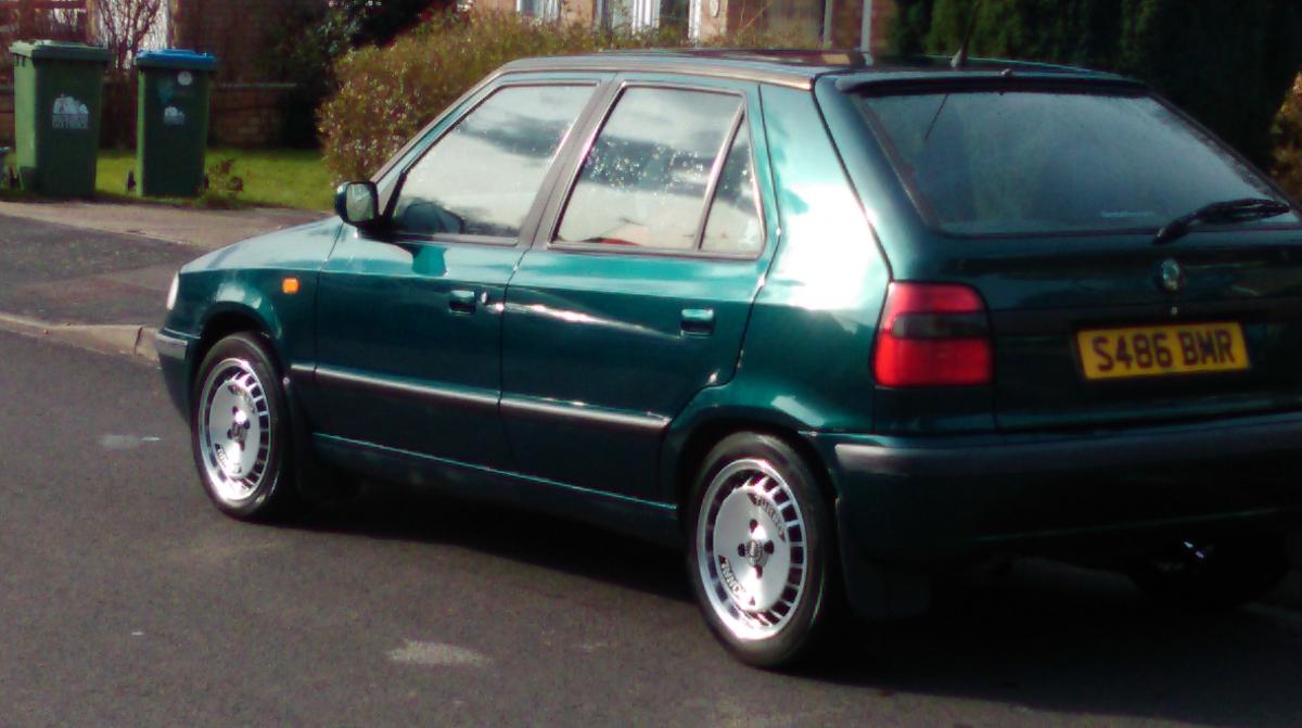

My Felicia has the original 13" alloys.
What would be the best looking larger wheel/tyre combination that I could fit?

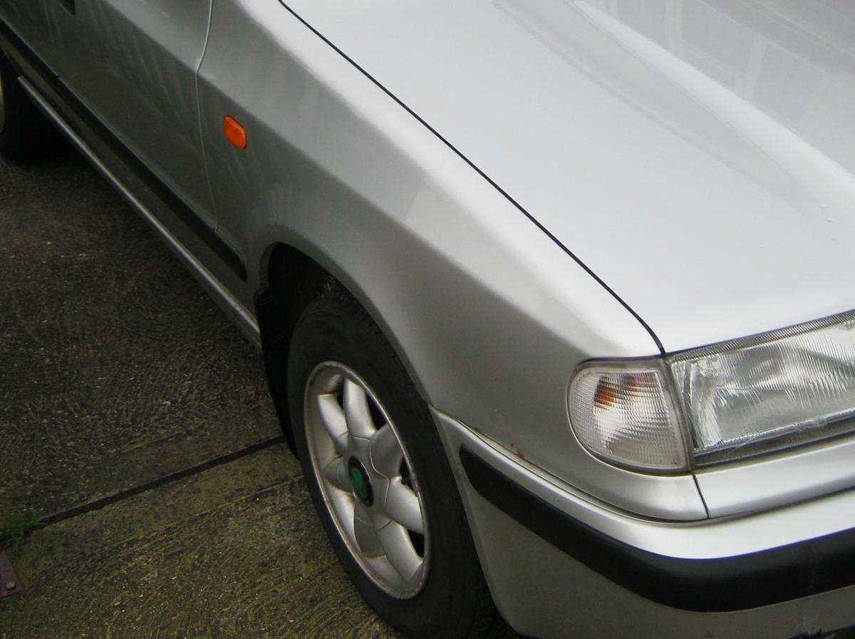

I have 15" Ronal Turbos on mine with 195/50 tyres. The ride is still fine, better than my other cars anyway and handling much improved. I love the six spoke alloys, the first picture in Ricardo's post but they were rare even when new but if I ever find a set I would buy them. I also agree with Ricardo that 14" is probably the best size.
