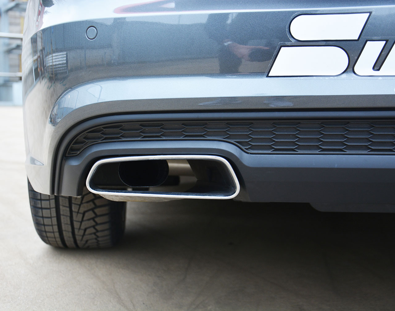

It seems this is the stock 280 setup
@MartiniB: have you also made the conversion to "visible" exhaust tips ?
What tips have you used? Are those Octavia 3 RS tips ?
going to add from Audi A6
Good choice  - looks good :cool:
Would they fit into the OE gap of the TSI280 lower bumper panel ?
Are you changing the lower bumper panel to the TSI280 one, or just cutting into the OEM lower bumper panel of the TSI220?
Do you have some partnumber for the A6 tips ? Or any suggestion on purchase them ?

Would I be right in saying the 280 exhaust tips are the same as the Audi A6 tips like the pic above only on the 280 they protrude slightly instead of fitting flush with the bumper?
The A6 tips are a different shape to the S3 diffuser, so will not look as neat as on the photo above.
