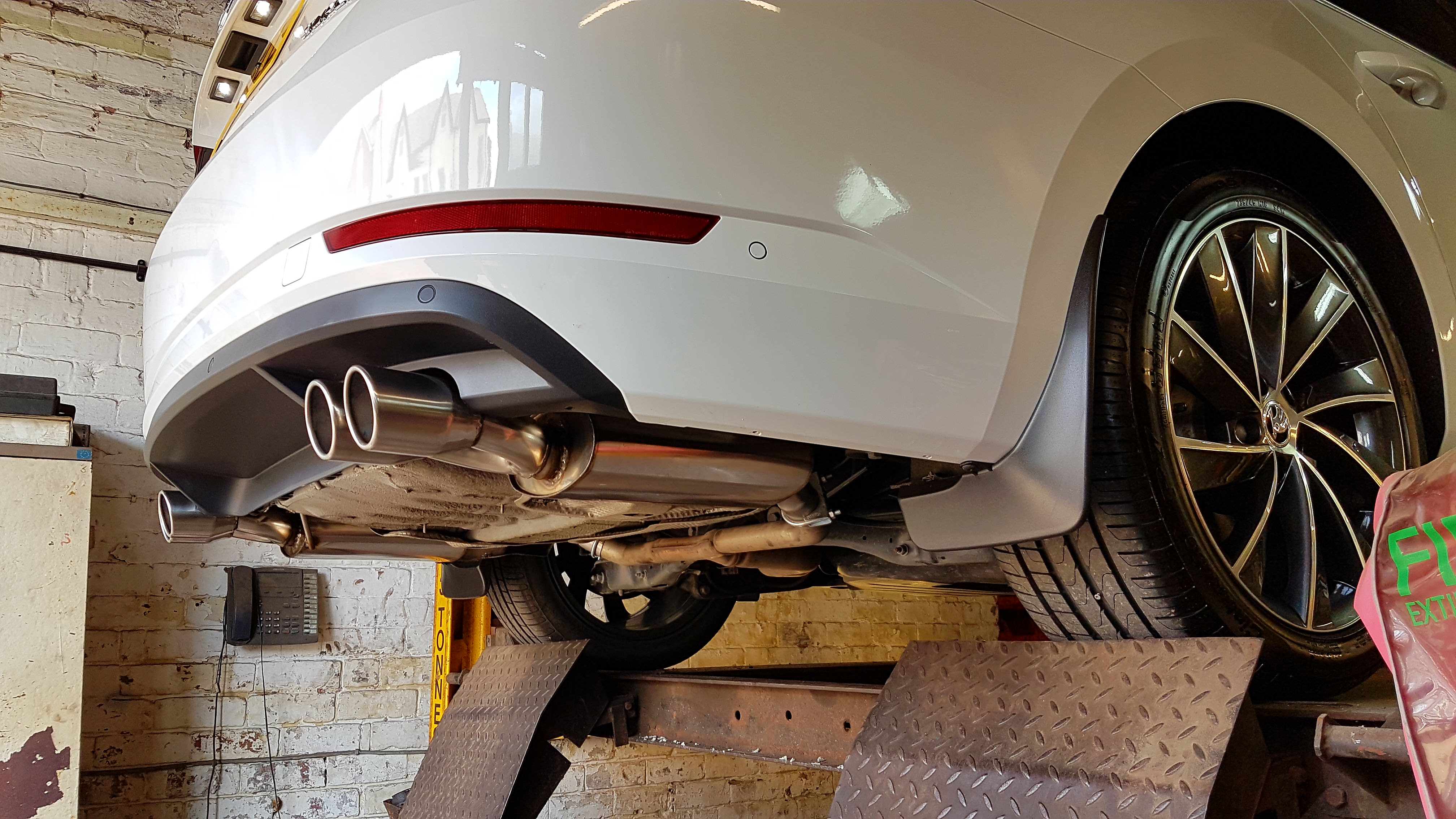

I had my exhausts fitted today :) very happy with the look, still getting used to the increase in sound but it's a very good sound!
Here they are, honest opinions?
The tailpipes look a little low for my liking but other than that it looks good.
Look very nice. Would love to hear how they sound.

Looks fantastic. Better than having them hidden behind the rear diffuser.:D
Update: basically, they were too loud. The guys at Custom Auto Fabrications managed to refit my original backboxes but with the new quad tailpipes fitted.
So now I have what I originally asked for - a great look with no impact on the lovely quiet luxurious ride of my L&K :D plus I got a bit of money back!

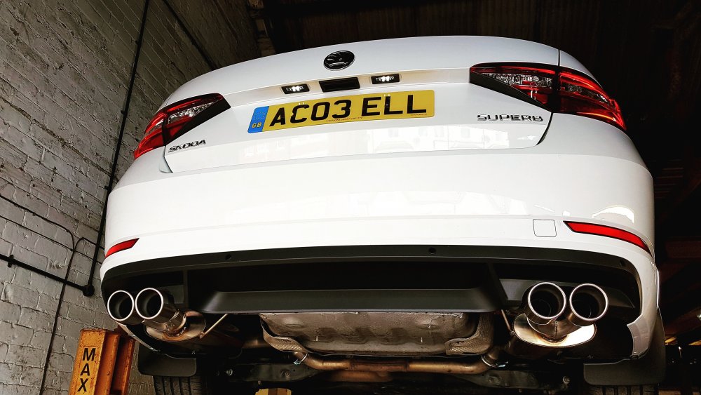

Well I've spent even more money I don't have on a new catback system which was designed with a lot of thought by the new owner of Eurosport Exhausts in Lytham St Anne's.... it sounds great at full throttle but cruising around just makes the 220 sound more like a golf gti which is perfect. I went for large amg replica tips with no logos and I think they look great :) let me know what you guys think.
