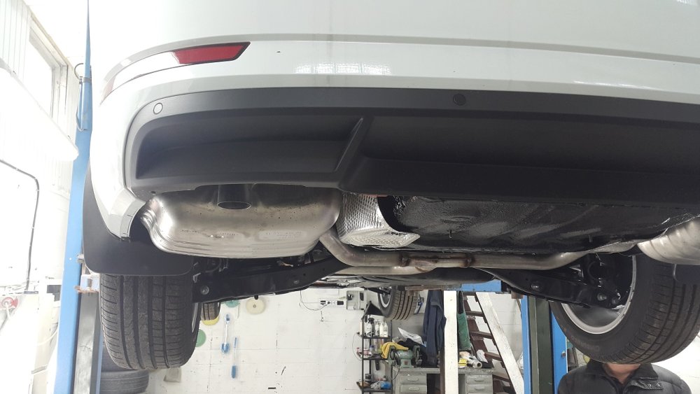

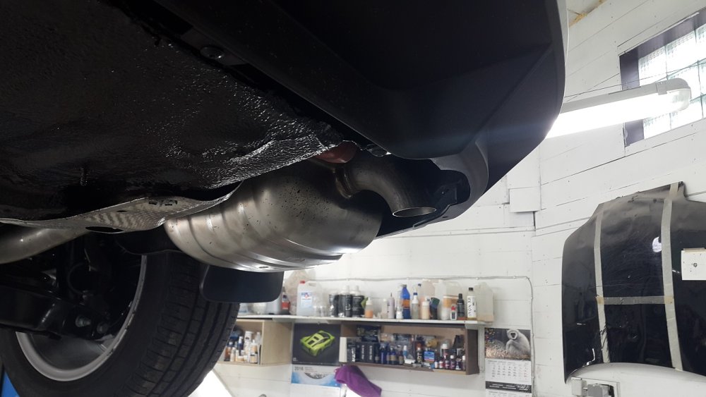

So you bought the 750E set of pair complete exhausts from the TSI 280 ?
Please come back with some pictures :) from installing
Correct. Shipping is 60 EUR more, so at the end it will be 810 EUR.
Next step is to connect the flaps to the engine control unit - will do it later and if those new exhaust will be more louder than mine.
There is one more thing - diameter of the connecting pipes in 280 exhaust are 55mm, but in 220 it is 50mm. So the assemby will be easier for welding, because there will be pipe inside pipe. The gap will be c.a 0,8 mm/side - and this to be filled by welding.
I will post the pictures, when done.

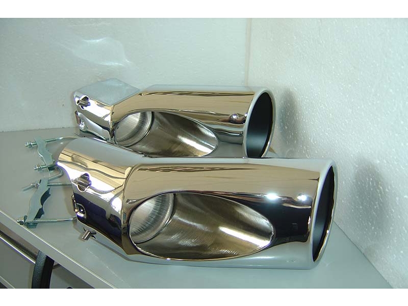

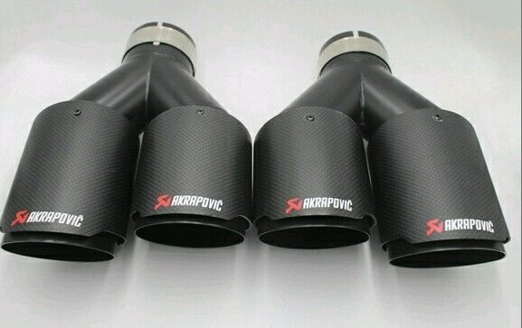

It is strange that the 220 tsi doesn't come with visible Exhaust's, Im buying a diffuser off another member in here but i collect my car latter part of march, I noticed the range rover sport, you can get some exhaust tips with hole underneath but still stick out back, interesting idea, i will be doing something but same as you MartiniB i am unsure what to do.
I just like a nice set of exhausts showing and don't want to spend a fortune.  so new diffuser and exhaust tips, been looking at the pic of some tips and maybe modifying.
see pics :-)
in the pic you see the exhaust tips you can get for a range rover, wouldn't want this but its an idea for a different exhaust but with holes in bottom. or is it a bit naff???
other pic of black exhaust tips i wondered if there was a way to make hole in bottom and make the car look a bit more sporty at back??

Here is a final result:
Here is how looks the spoiler:
Vy8EC4Kr-rXzzijqM0l-2EaDyBpPQwhFC8pC_j-3
TyqUWg8uuOSc9FFqp0bysGfT8JFMx6rLQmw71uG3
