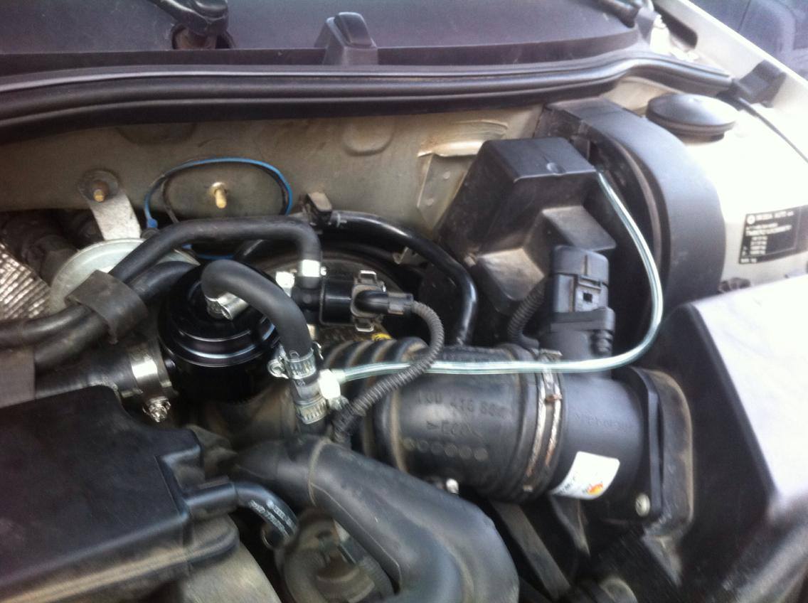

i connected the boostgauge to the dumpvalve hose to see if it worked better now  with a new dumpvalve but it dont work like it should it just gets up to the 0 at full boost so i guess it must be broken
or have i connected it wrong ???

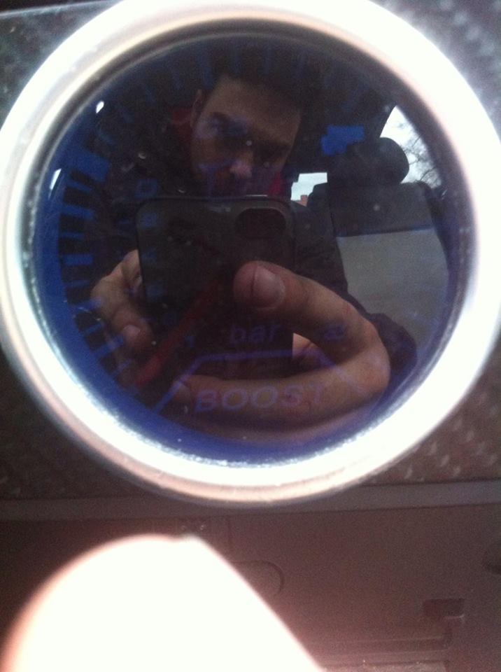

 here is a pic of  my boostgauge at idle is it normal that it gets sucked down this far
it will sit about -0.6 bar I think idling (I will check on mine tomorrow) ... its generally in negative when cruising, always bangs up high (1-1.4 bar generally,peaking at 1.6 on the initial surge) when foot down...... you have connected it like mine (I did it there from a recommendation on here) and mine works fine (it was a cheap one too) you have the pipe into the wiring loom, as long as it goes through without getting pinched anywhere it should work! (does it settle to zero when the engine is off?) If the car is running properly, it seems the ONLY thing that could be wrong is the gauge itself.......(cant  quite see what its reading in that pic)
maybe there is a leak in that line somewhere? it would probably show as a boost leak though, throw up the fault code and loose power...... if its running well, only thing left really is the gauge itself.
okeej yeah the car is running great now and has alot of power  the gauge goes back to zero when the engine is turned off or a little bit over the zero guess its not calibrated exactly right
and i dont think the vacum hose is pinched anywhere and i have cableties on the vacumhose both on the T and on the boost gauge  so it shouldnt leak

If you have fitted the boost gauge to the line going to the top of the diverter valve its in the wrong place. That impulse line will only ever see a vacuum when you shut off the throttle to open the DV surely?
I'm sure most people tap into the fuel pressure regulator line
Edited by SuperbTWM
works there in my car... and thats where someone else on here put it, thats why I followed on! lol...
Yea, after thinking about it, while your on boost it applies the boost pressure to the top of the DV to keep a positive seat on the V/V as well as the spring, then when the N249 switches over you get the vacuum reading.

i still have my n249 is that why  my boost gauge dont work ??
or should i just tap into the fpr vacum
