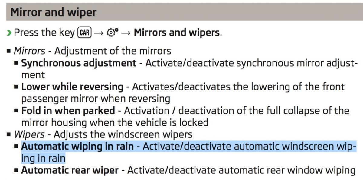

On the Octavia, you can disable the 'auto' setting in the infotainment and the wipers just become a variable intermittent type. Is this option on the Superb? Has yours been disabled and in fact is now just acting as a standard intermittent wipe?

The wipers are enabled in the infotainment section also.
