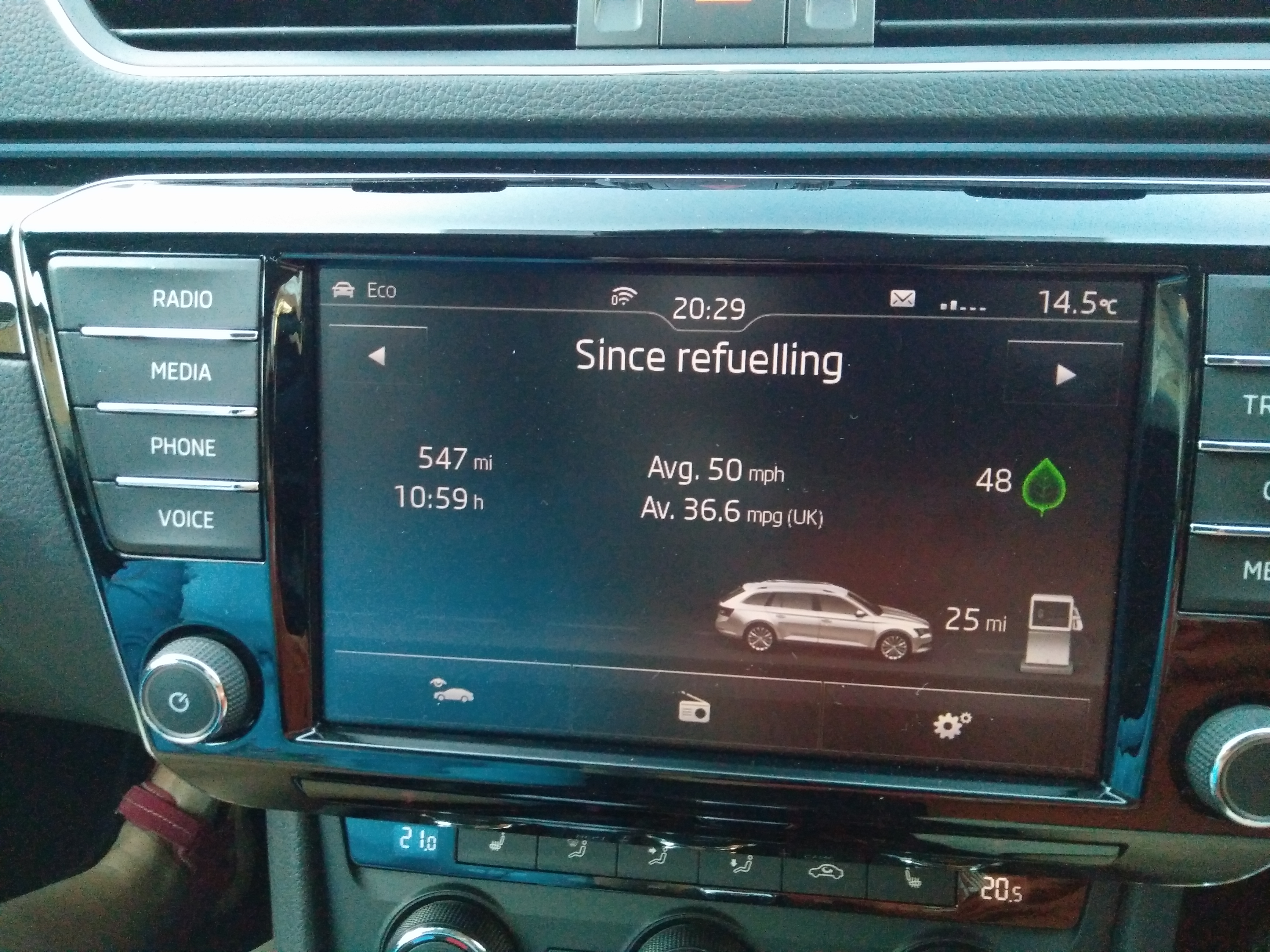

Got some good stats from a longer run today:

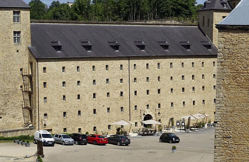

Nice red car in front of the Hotel Chateau Fort. A rally turned up with Austin Healy's, Triumphs, Aston Martins, Ferrari's, Lotus Elite and a bunch of chaps in their late 50's.

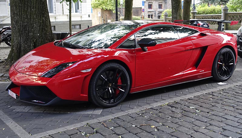

I almost got in this Lambo parked outside our hotel in Bruges. I'm sure it's Corrida Red – the plate says "REDBULL"
