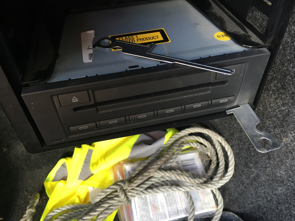

Is there some special trick to removing the CD changer in the boot? I've inserted the removal tools, and tried pushing it, levering it, hitting it, trim removal tools, brute force and swearing, but it won't budge. Is there a secret button I need to press, screw I need to remove or goat to sacrifice to get this out?

Are they the correct tools, it should come out easily using nothing but the tools.
As far as I know, they are the ones that the Fabia of the same age use, the slot looks the same and they appear to fit?

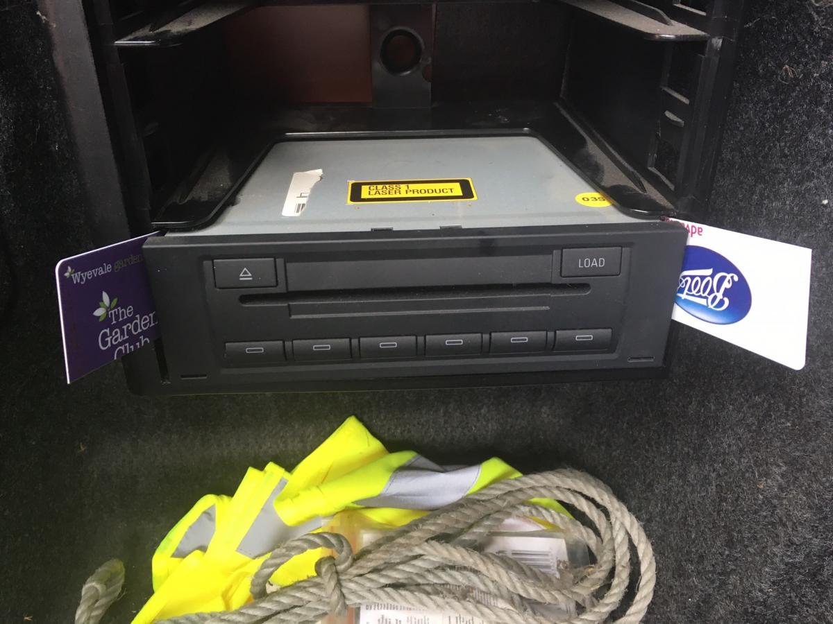

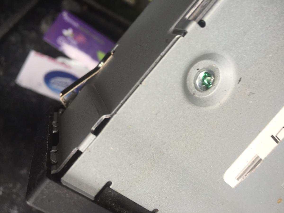

In case it helps anyone in the future, I managed to get the CD changer out by taking two old credit cards, chopping them down to two thirds their original height, and shoving them in either side. This is enough to push in the little lugs and pop the changer out.
The lug on the right of the CDC can actually be pushed in with your finger as there is a hole on that side of the rack, but the one on the left has no hole so you need to insert the card on the left for sure.
