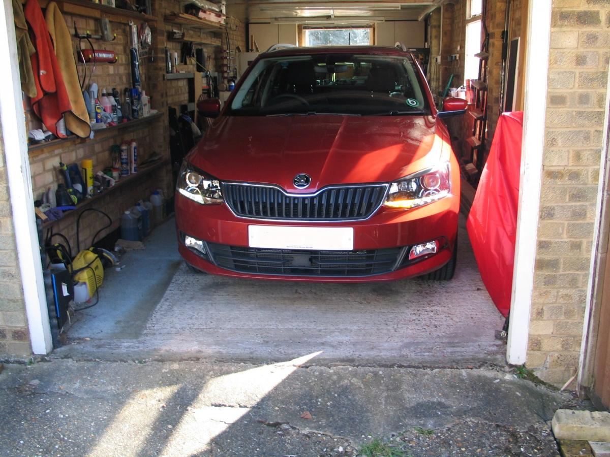

The daytime running lights and the side lights use the same LED array, the only difference is that when acting as DRL's they illuminate brighter than they do as side lights.
What you're probably seeing on the third click is the side lights not the DRL's (which is backed up by the fact that you get a "lights-on" warning when you turn the ignition off and try to leave the car).
Ask the dealer why your DRL's aren't working when you take it in for the service and let us know what they say/do.
I have attached some pics which (hopefully) show what your lights should be doing.
post-102636-0-48243300-1461165970_thumb.jpg  Both daylight running lights on
post-102636-0-42919400-1461165996_thumb.jpg  Both side lights on
post-102636-0-89258400-1461166020_thumb.jpg  Drivers side DRL, passenger side DRL dimmed for indicator

Hey Fabikent, thanks for the photos.
The first photo are the so called DRLs I have when I turn the light switch two clicks to the right. So essentially they are parking lights I have on and not DRLs.
