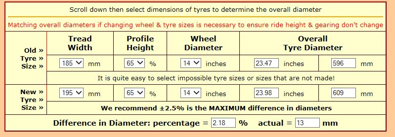

http://kouki.co.uk/utilities/visual-tyre-size-calculator
