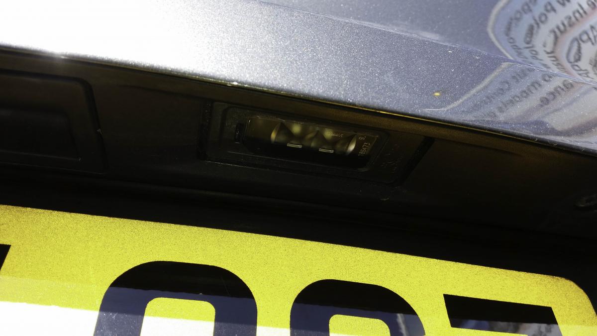

How do you remove the number plate bulbs? Sounds stupid I know but I didn't want to force them by just pulling them out. Is there an easy way?
And just to clarify I mean the whole rubber casing etc out of the boot lid
Here is a video.
Btw I don't like this screwdriver method, there's a big risk of scratching the paint.
I just pushed it to the left with my fingers. You can use a plastic tool as well.
Edited by aki78
That's perfect thanks mate

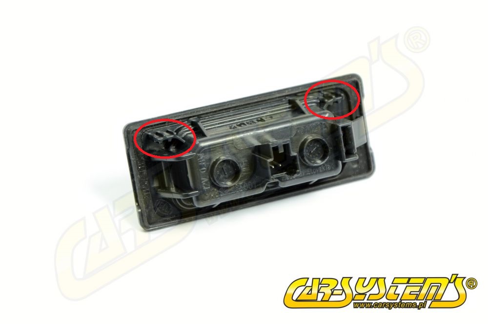

The OEM VAG ones you link to are the ones that have been around for a while. They do need a tiny modification to fit the CORRET way even the OP found that out if you read the thread you link to. The location cutouts are on the opposite side on the Octy (on the 4 I have done). If you fit them as they fit through the hole they will be pointing the wrong way, not on your number plate but at the cars behind you. You just need to shave the location lugs off the lamp, I will post a pic later of what I mean.

This is not the way the lamp fits into the Octy. But then the lamp is not listed as fitting it in the first place. To fit the lamp with the black stripe away from the car you need to shave off the locating lugs as below then it will fit the other way around. The locating cutouts are obviously on the other side to the other cars

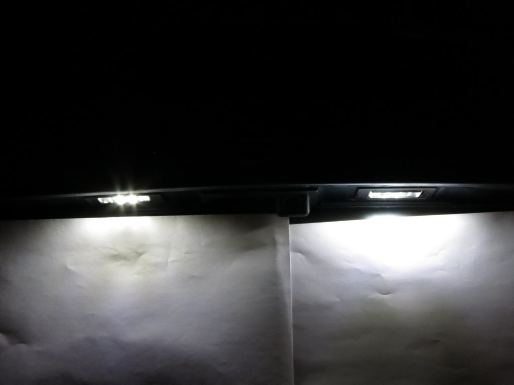

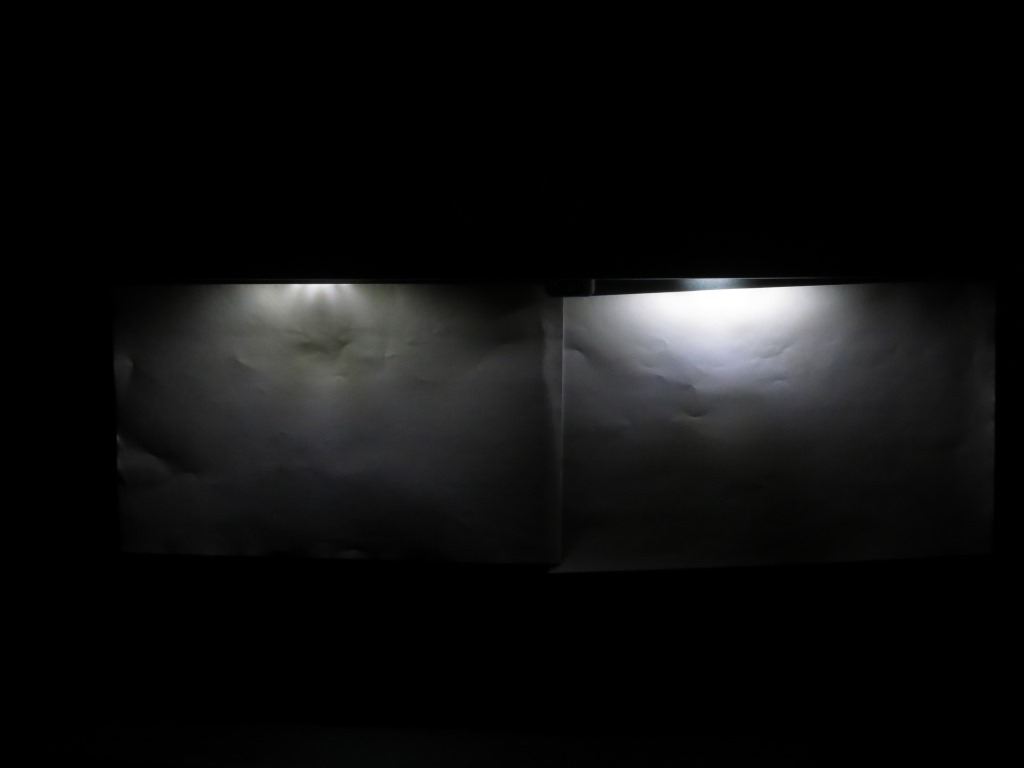

Just for a laugh and to check my sanity I turned one around and took a couple of photos to compare (Used white paper over the number plate for clarity)
post-125891-0-43668200-1461534758_thumb.jpgpost-125891-0-63869000-1461534773_thumb.jpg
the one on the left is with the black stripe nearest the car, as it would fit unmodified. You can see it does not light the number plate as well (as it is pointing the wrong way) and a bit lower you can see the LEDs shine backwards on the left one.

Thanks for showing that, that makes a lot of sense now. You can clearly see where your way round is much brighter on the paper, although it lights up a smaller portion of it than the other way...
Might have to start shavin' me bits now so they fit properly!!
Edited by FluffyEyeball
I know it does look like that in the picture because the paper was not completely flat and some of it was in shadow on the right, the light comes at a very shallow angle. it was not the easiest to do in the wind and rain!!
In practice there is a huge difference when you see it, in the brightness and the spread there is no mistaking which way round they are meant to be. They are very effective design actually
