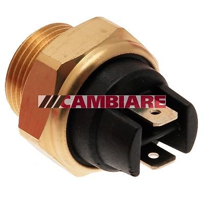

there are two types of radiator fan switches. one opens at low temperature and another one opens at a higher temperature
you can find new ones on ebay or on some website online easily. mine is like the one in the picture 68/82 degrees celcius
make sure you replace the gasket also and dont crazy tighten it.
