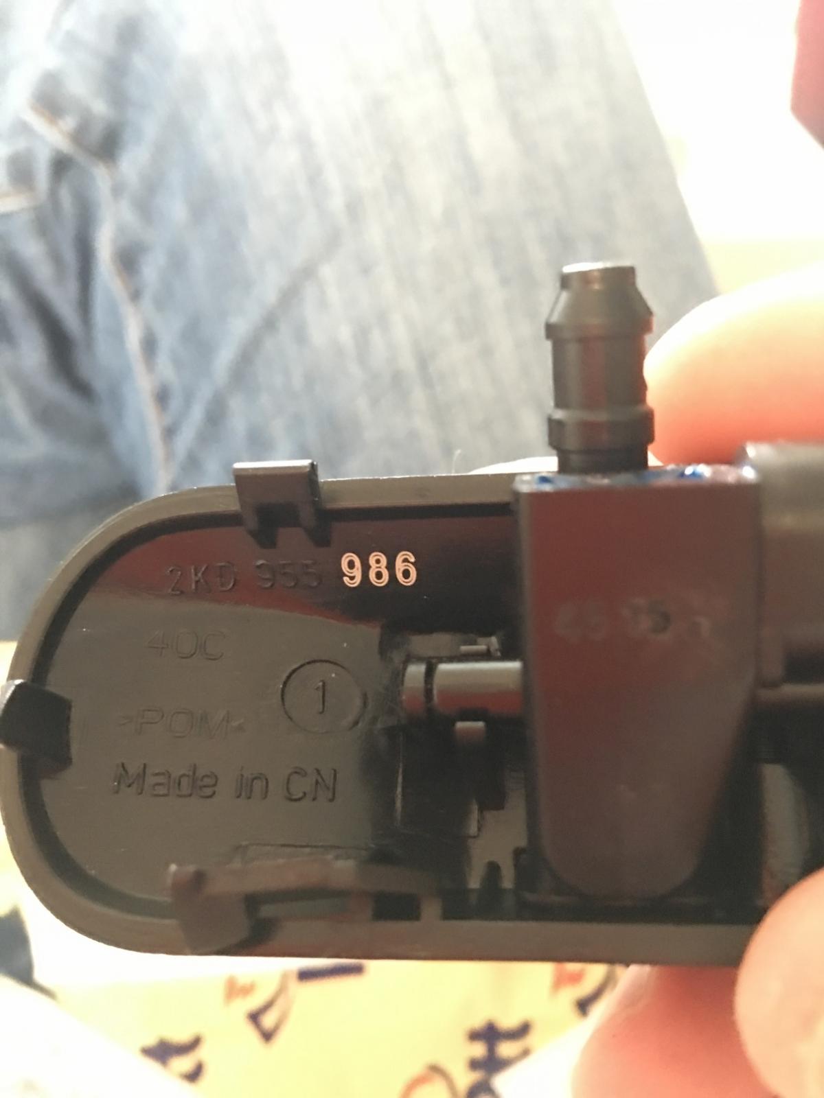

The new fan style washers I ordered have the part number: 2KD 955 986. I ordered them from an eBay seller in Turkey: £30 including postage for the pair. They arrived in about a week.

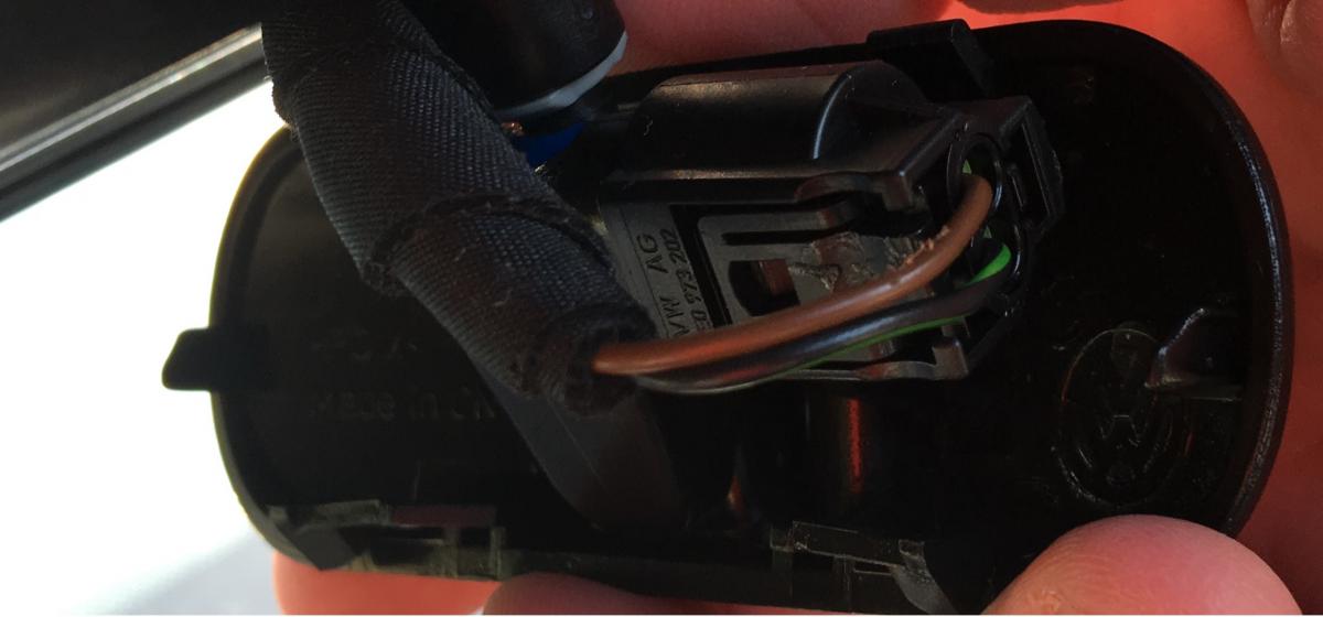

My nozzles are heated, so there is the additional step of disconnecting the small electrical connector, easily done with a Leatherman's needle nose pliers.

Installation of the new nozzle is simply the reverse: the electrical connector simply pushes back in with a click when it's fully home. The hose pushes all the way home onto the nozzle, the little collar rotates back round and clicks into place. A GENTLE tug of the hose will verify if it is secure or not.

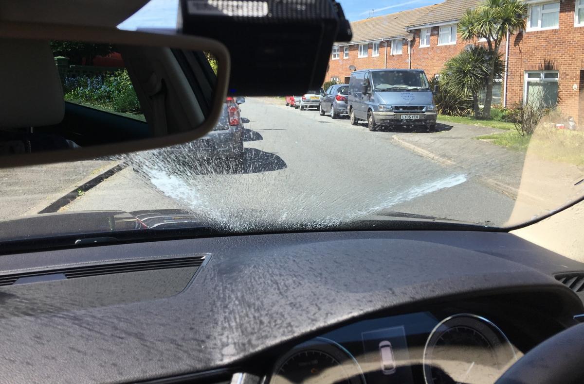

The new spray pattern is more than acceptable. I might have to fine tune it a little, once I've driven the car and used them a bit more.
There is a little bit of overspray, but it's no worse than the nozzles on my Mk2 Superb, or Octavias before that.

New nozzle re connected:
New nozzle spray pattern:

Interestingly, the seller has quoted the part number 5M0 956C 9B9 but the part I got was actually the one I quoted in my original post  :think:
Despite the apparent mix up. The part I received is the correct part and was a perfect fit.

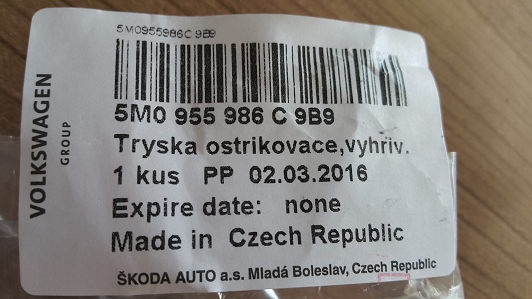

I have visited today VW dealer Moller Auto Riga and bought Nozzles from the Passat
5M0 955 986 C 9B9 30€*2
Made in Chech Republic

about code 2KD ... they told this can be for another region like South America

non heated from the Passat
5M0 955 985 C 9B9 ~10€*2

Thanks a lot MartiniB for this spare part number.

And the spray pattern in dstev2000's picture looks a bit low/weak? Will it not hit only in the bottom of the wind screen at high speeds?
Maybe he didn't set them to the car. My ones aren't that low. But I spent some time on regulation. Still in my opinion those from Passat are better. More even cover over windshield and I think it uses less fluid for this same job. But like for most of the stuff. It's a matter of preference.
Sent from my SM-G935F using Tapatalk
The rear one is worse I think. It only gives a bit of mist at the top. The rest goes more or less to the side. Maybe I have to regulate it a bit.
