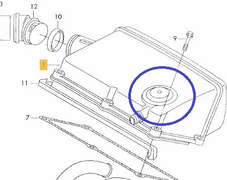

Hi, the intake manifold cover has lost it's round cover seal which sits on the top bottom right corner with a spring underneath it, I can't seem to find a supplier selling it, can anyone help with a supplier or even the part number, as I drawn a blank with Skoda.

How about a photo with an arrow pointing at the part in question? A description like "top bottom right corner" is quite challenging to say the least.
Best picture, I could find - thanks
That piece could be better described as a breather cap.

Looks like you can only buy the complete cover £100 appox found the case number 028129037 B
The circled part is called pressure regulating valve for the crankcase breather (as Rich said). But as you've mentioned you can buy it only as a whole, the cover for air intake. I don't see it happening in the UK though. In Czech Republic it is available (part number 028129037B) at around 85 Euro (http://www.amd-autodily.cz/motor/kryt-pro-saci-potrubi.html)
So my advice is to repair the one you have or find a SH one in a breaker yard.
