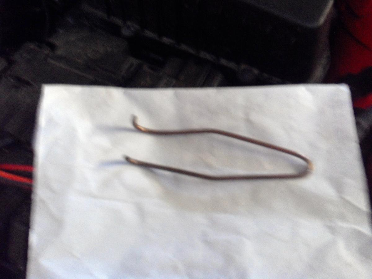

The tool needed to remove the ignition coils is the same as when the plugs were changed,
who changed them for you.?
You can make a tool, or use other methods to get the coils off, but best use the correct tool.

Draper Tools etc,  any VW Specialist Garage doing the job or good garage will or should have the Coil Removers.
I will post a poor pic of what i have as a home made one.

This is what the real McCoy looks like.

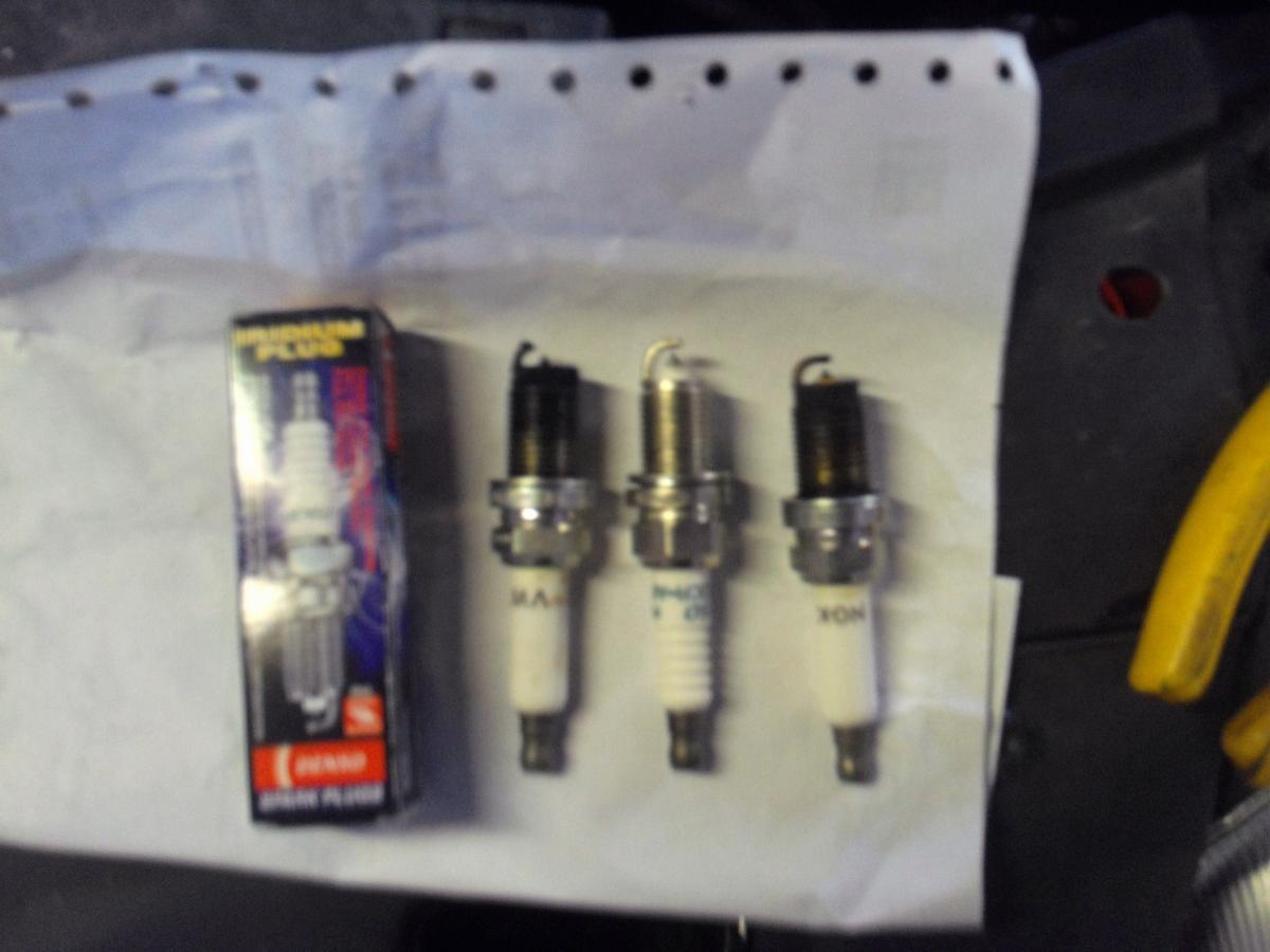

Well after a frustrating afternoon yesterday I finally got this sorted, changed the coils and it ran much better, but once I gave it the beans it was very hesitant and the engine light came on flashed then went off did this each time I did heavy accelaration, but the EPC light didn't come on, read the codes now said Cylinder 4 misfire, but code went as soon as the engine restarted.
So I swapped the coils out on 4 to a spare new coil ( I ended up with five new coils (don't ask lols)). Went out again same thing again on heavy acceleration the engine light would flash and it would be very hesistant read the code and this time cylinder 3 misfire. At this point I was getting frustrated so I nipped down to a mates garage and got the codes read on a proper machine. He confirmed lots of misfire codes on all of the cylinders, and his guess was the spark plugs. Advised changed about 4 weeks ago to denso, he said defo spark plugs, and that these engine are very high strung, and in his experience they run much better on standard plugs.
As he was busy (wouldn't be able to do anything on the car yesterday) I said I'd try check the plugs and try changing, so I popped to the skoda dealership as it was on my way home and got some plugs. I took the denso ones out they looked good, cylinder 2 was sooty but I think this may be down to the dodgy coil, but I did notice instantly when comparing the skoda oem (NGK) plugs to the Denso ones that the gaps were noticeably bigger on the denso ones, I checked the part no and they are defo the correct ones. Put the new NGK plugs in, and success no fault codes no engine or epc light, and my god its like driving a different car much smoother, feels much quick, all the hesitation has gone so I'm a happy boy again :-).
I'm not sure what happen with the denso's as a garage fitted them for me so I'm not sure if they were incorrectly gapped out the box, or the garage gapped them incorrectly.

What part number is the DENSO Plugs, did you get the VK20?, As Euro Car Parts show!
   I Never used them, i use the correct DENSO ones.
I have seen others mention using them and no issues.
I like the ones that work best, and even last to what Skoda / VW say their OEM fitment should,
and run great with Stage 1, Stage 2 or a Tuning Box.
As to highly strung and the Latest VW Recommended OEM plugs,
they are certainly not Long Lasting,  but the Plug Gap has been changed since 2013.

I got the Ones form Euro car parts, I cant remember the code I'll check when I get home, what should the code be?, maybe I got the wrong plugs VK20 rings a bell, my friend has worked on quite a few of the VW and audi varients.
VK20 is what they list cheap and supply.
  You need to check the GAP, and the gap can be put to 0.7 or 0.6 if you want.
