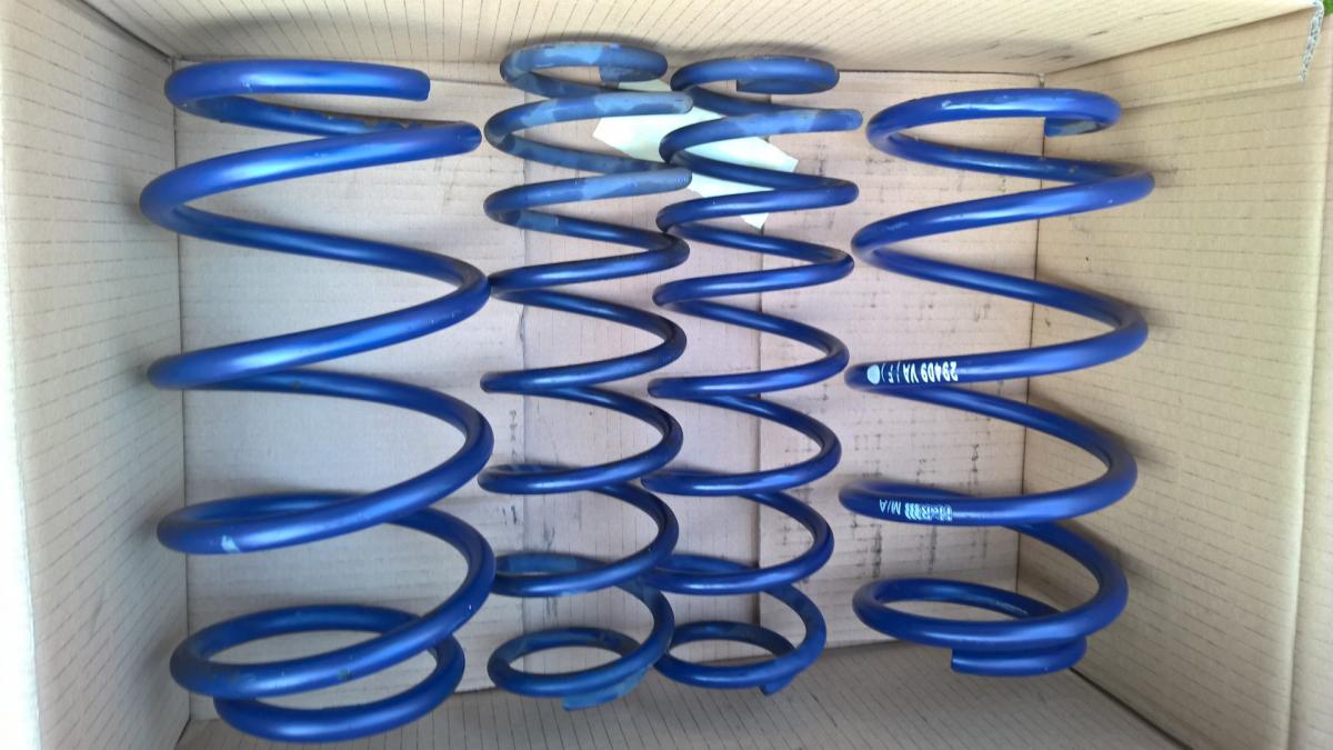

I have a 56 plate VRS which has coilovers fitted, if I were to remove them I need 4 shock absorbers and 4 springs. Now I have some standard springs but which go to the front and back as they are a different size.

Wide springs on the front, narrow at the rear,
H&R springs, but will look similar, outer springs for front, inner for the rear.
