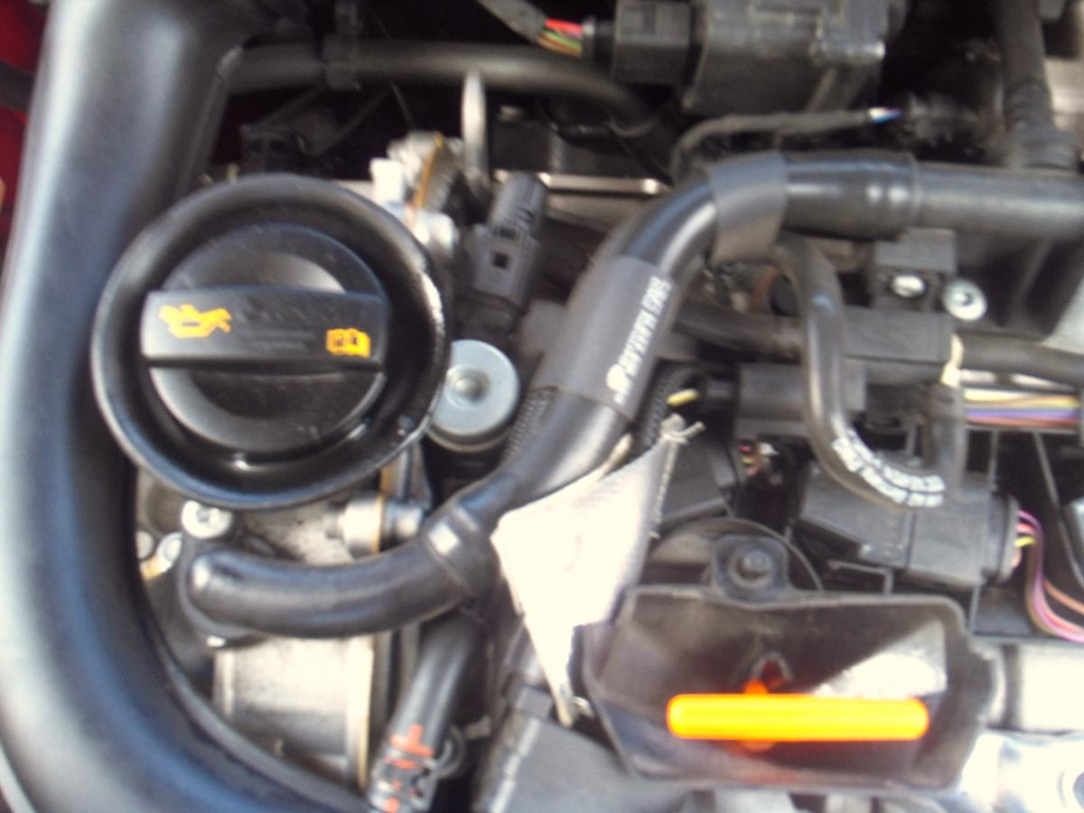

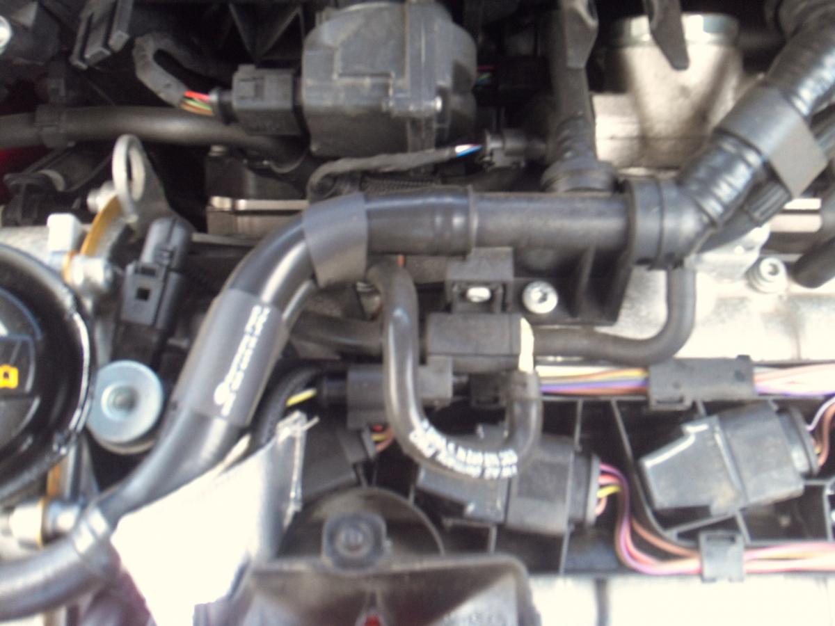

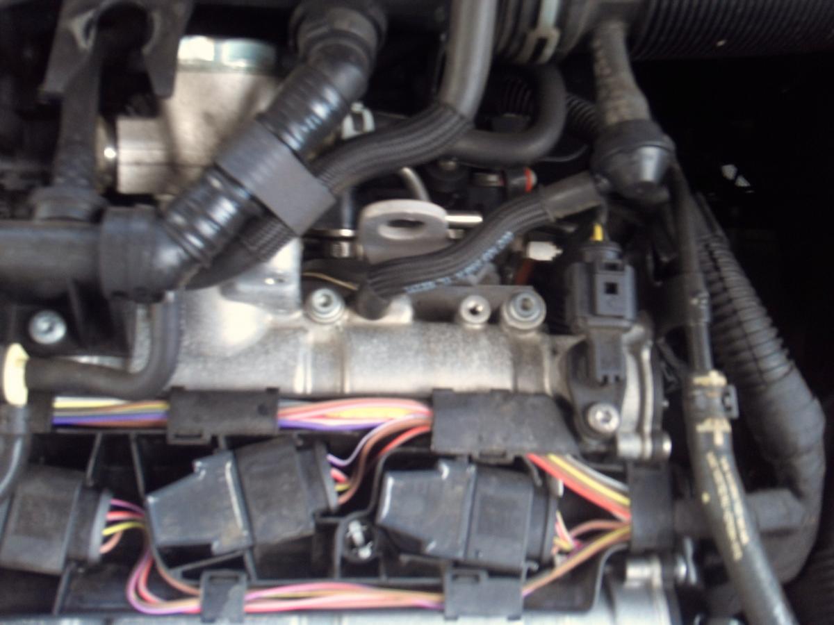

All looks as it does in your photos (tnanks for the photos too). There are a lot of pipes channeling around but all look in good condition & I cant see anything loose or poorly connected
