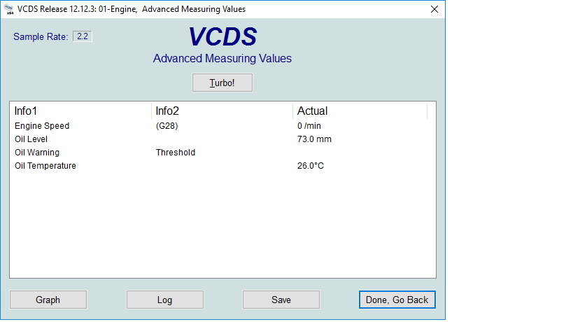

Can you give us a snapshot of the VCDS reading on the oil level stats please. Once when cold and once hot whilst running please? I'm wondering if it throws a yellow light if the oil level doesn't change when running as it reckons no oil is being picked up. Although the oil pressure sensor would typically pick this up.
Will do mate. I'll take a reading tonight when I get in, then jack the car up to inspect the sensor. It'll be a few hours until I can take the cold reading.

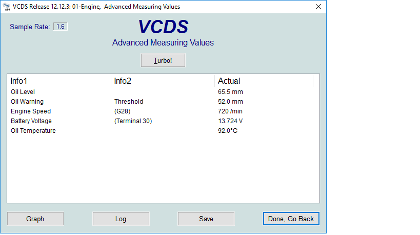

OK, results are in after letting the engine cool this evening.
Engine off, and cold (well, 26C):
Engine running at idle, operating temp:
I had a snoop through the instruments adaptation section. It was getting dark and late, so I didn't go too far but I saw two items of interest:
ESI: Oil Quality
Poor Oil Quality
(3)0ESI: Code service interval extension-oil level
oil level evaluation
I'm entirely guessing, but I'd assume "Poor Oil Quality" refers to me not being on long life oil?
EDIT: The plot thickens. I wonder if I've perhaps chosen the wrong service indicator reset? Presumably I'm on fixed servicing, but when I used VCDS SRI it said my car did not support it, and I had to use 'ESI - resetting ESI' from the instruments adaptation page. I I wonder if my car is set for fixed servicing, but because I've used Extended Service Indicator (without knowing that's what ESI stood for at the time), I've got a wrong value somewhere...
Reading it suggests I've not quite set up the values for the service reminder, which might be why the light keeps coming on
