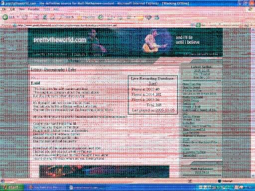

My screen goes a bit funny now and again (every 20 mins), it usually starts when scrolling and gets worst and worst until you can't make the screen out... :thumbdwn: It is fine for another 2-20 minutes after a restart...SO, what could it be, any ideas? Graphics card :confused:

Err... (warning: Non tech answer coming up), err, it has got a deadicated 64mb graphics card in it, and is not built into the motherboard... I think any memory is soldered onto the board. Please note, it has taken a few knocks (punches in anger:rolleyes: ) over the two years of it's life! I thinking it may be down to that! :o
Long shot: reinstall the graphics drivers.
Most likely: The graphics card is dying, get a new one :)
Erm, if you've managed to get a screenshot of it on here, then it's not going to be monitor or cabling.
Have you had the PC freezing or re-starting itself? I'd give some new drivers a shot, but I doubt that will cure it. If it's a 64mb card like you say it probably doesn't owe you anything. You'll be able to pick up a perfectly respectable AGP 128mb card for £25 these days :)

Wardy, thanks for the offer, but it has an on board graphics card too... I could probably use that one, if I knew how to change it over... :confused:
Ah right, no worries. In that case, you might find that if you just remove the card from its slot, then power up?
If not, it'll likely be a BIOS setting. May well be in the 'Integrated Peripherals' section or something similar, to enable the onboard graphics.
