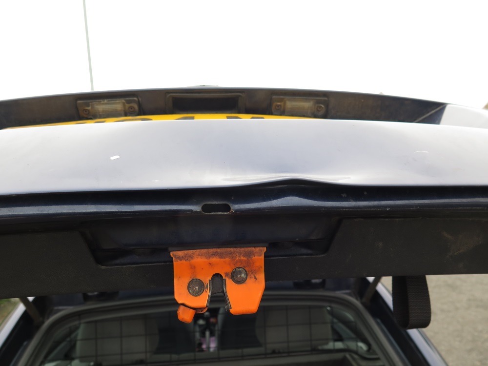

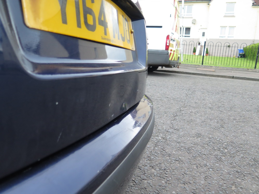

The mrs got rear-ended this morning in her 2001 estate. Fairly low speed, but enough to bend the bonnet of the offending vehicle.

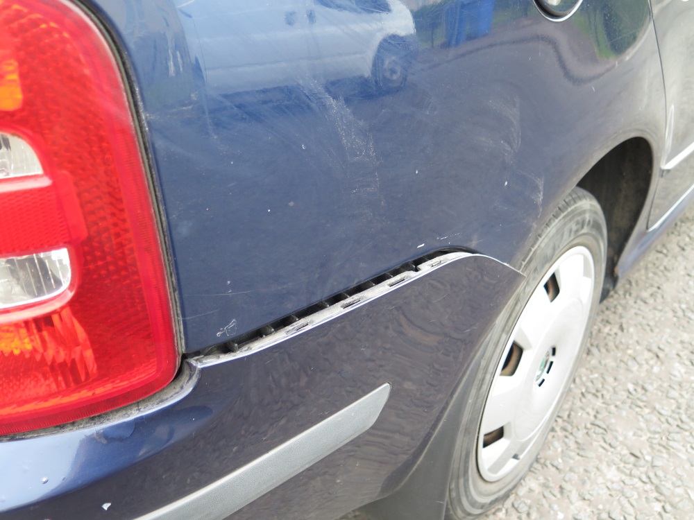

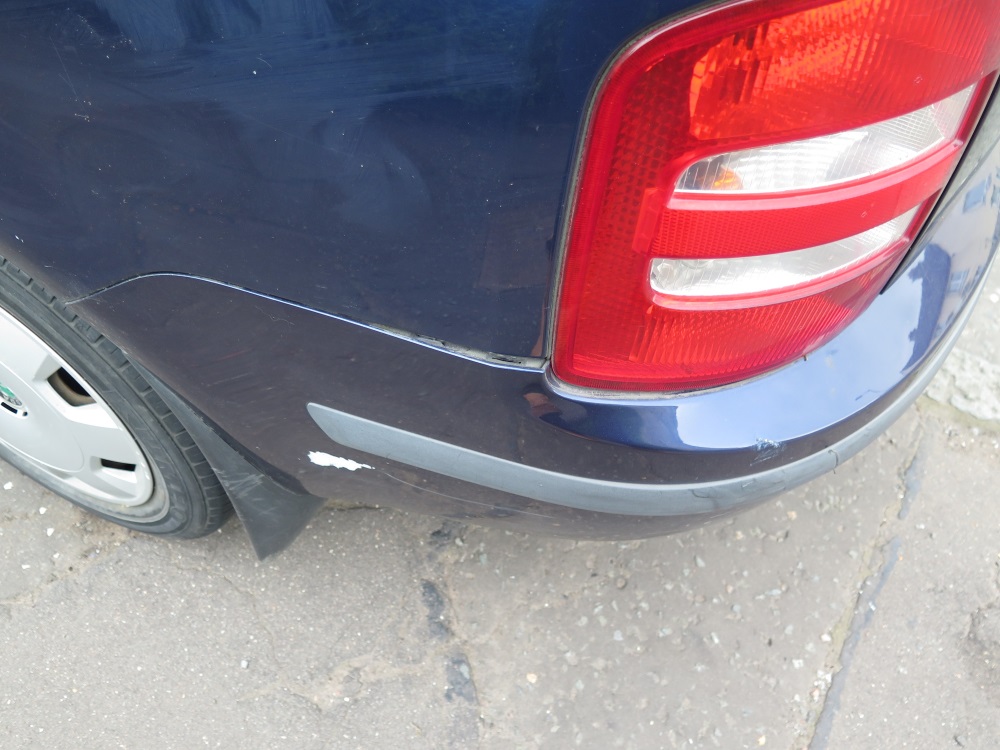

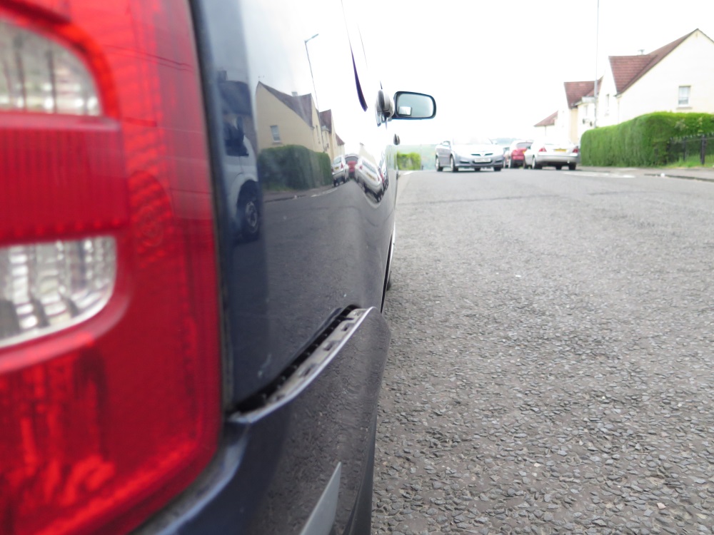

I've not seen it yet, so this is all second hand info, but she's reporting that there's a dent in the tailgate, and the bumper isn't sitting right at the sides. Also the boot isn't closing like it should and sometimes won't open.

The Rear bumper is an outer skin that bolts on under the rear lights and inside the rear arches, the impact will have pushed it forwards and prob damaged the crash bar that's underneath the bumper, main thing is if has kinked the rear 1/4 panels it's gonna be a swine to repair.
Accepted bodge method would be bumper off, crash bar off, hammer the back panel straight, second hand crash bar then maybe a second hand tailgate.

I'm afraid until you start stripping the bumper off you wont see the true extent of the damage.

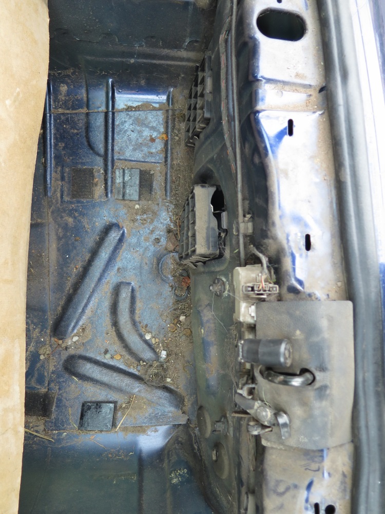

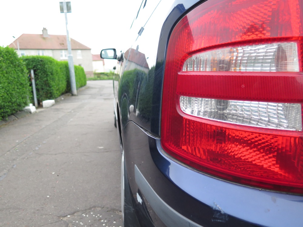

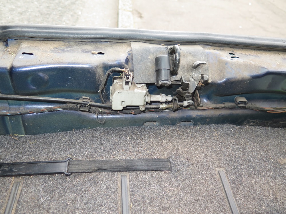

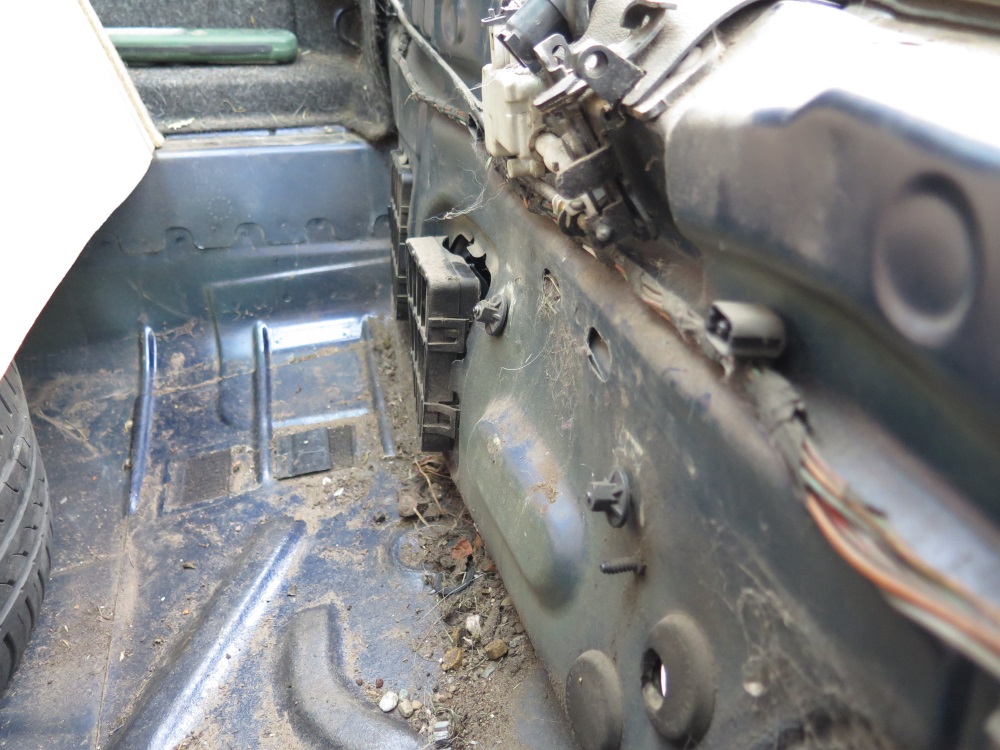

Had a look at the car last night. It's taken a fairly hard whack to the rear, but held up admirably. The rear slam panel had been pushed forwards a bit, as well as the wheel well floor, which was causing the tailgate to fail to latch. I managed to knock that back with special tool number 1.
Turns out boyo is a mechanic, so he's offered to look at the car, repair it (he's already ordered a crash bar for it), and put it into his body shop to get the dent sorted. So, if he's good to his word, that's a decent result for all I think.
Some pics below. Full size originals here.
