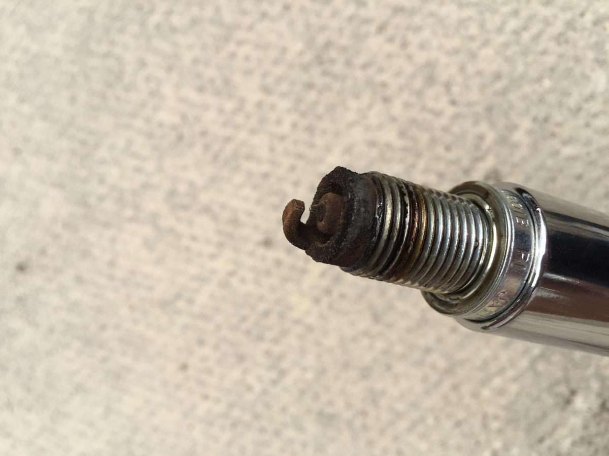

Got flashing management light and misfiring on idle badly yesterday-
But fine when revved and driven hard.
Checked the plugs to show this.........
Not good.
So what is the car, age & miles.?
New plugs required,
latest software from Skoda on the ECU,
 5w 40 Full Synthetic Oil (VW 502 00)
99 octane fuel
& all might be well, it depends how much of an oil user it is.
PS
Do not rev hard a Twincharger with one bad plug.
The issue is on Supercharger & Turbo between 2,400-3,500 rpm under full boost and a cylinder misfiring,
it can be very costly when 2 cylinders shut down or the Turbo,
and hope hope they shut down before damage occurs.
Edited by GoneOffSKi

Not good.
New plugs required,
99 octane fuel
PS
Thanks for the info!
Yeah, putting new plugs in.
It's April 2011 with only 32k on the clock, not sure if it's had ecu update but it has had the dsg oil change, not that that would affect the engine though.
It does use oil, 1.5 litre in 3k miles....
Already running 502 spec oil and 99 Ron.
Shall just see what happens over the next few days!
Ask Skoda UK if your car ever got the Breather Pipe / Valve update, and then it should have had an engine ECU update.
That might have helped and still might.
(No matter if out of warranty they knew many needed it when in Warranty.)
Different from the Software Update when the DSG Service campaign was done.
If the plugs have never been changed they could be well overdue even though Skoda / VW say the OEM Long Life plugs are good for 40,000 miles.

Did new plugs get fitted when you posted those in post #8?

The motor was service at 29k by main dealer-
Plugs, filters etc-
Post #8 was supposedly those plugs- that is if they'd put new ones in as listed in service info.
Filter is brand new though, checked that out!
I've got new plugs on the way to fit this week.
