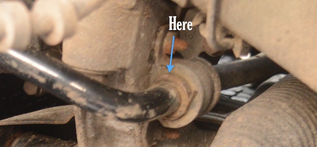

The camber is a bit lopsided on my ibiza 6L pd100 and i either need just new droplinks or a new ARB/ARB bushes.
I think the ARB is bent, there is a bend just as it exits the bush and the paint has bulged and cracked like it's been squished.
I will try new droplinks first before anything to see if it cures a bit of knocking on both sides (other components are newish)
