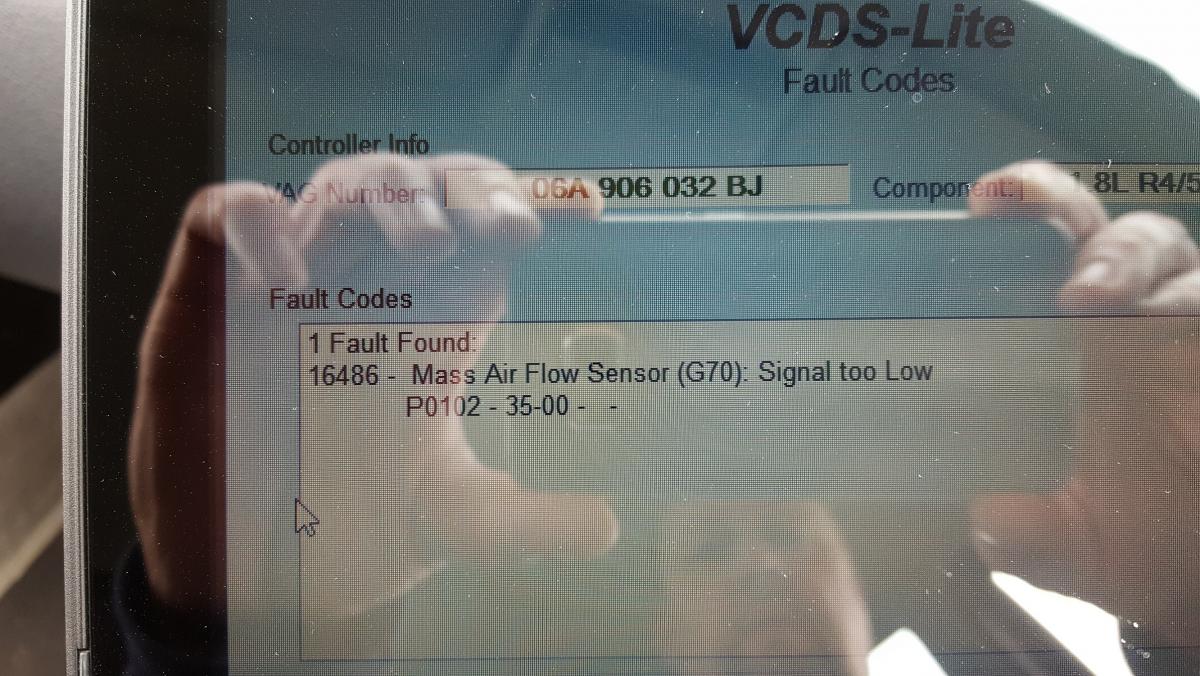

Good evening chums,
Out in the Vrs earlier, running fine.
Came to a slip road to join a motorway, booted it down in second gear as I love to do :) and I had a very momentary loss of drive - really quick, very sudden - electrical type rather than fuel-related type, if you know what I mean, due to it's sudden-ness. If sudden-ness is a word..?!
Kinda like if I'd flicked the ignition switch off and on in a tenth of a second.
Anyway, following that, it was fine again, pulled as strongly as before. No misfire, no loss of power. Behaving perfectly except....I now have the check engine and traction control lamps permanently lit. Several ignition cycles and driving periods have not cleared the lights. I usually get these lights on with a coil-pack failure, but this time coil packs are fine - there's no misfire at all. I initially wondered if it was an ABS wheel sensor, but I did a couple of emergency stops and the ABS is working perfectly. Pressing the traction control button on the dashboard has no effect on the light, it stays on.
I'm learning towards MAF, but I really have no idea. I know that the first port of call is a scan, which I will do tomorrow, but I was wondering what the Brisky collective was thinking?
Thanks as always chaps.
Looking at what you have already checked, I would say you're thinking is leaning in the right direction, but the scan will reveal the most info.
Have you tried running with the MAF disconnected?, does it still do it?, or has the initial fault not returned, just the light?.

Thanks matey. And as you say, scan for the win. Just wondering out loud tonight before I arrange a scan asap.
No, haven't tried running with MAF disconnected, but then again, the car's running perfectly - exactly as it should, which is odd because I would imagine if it was a MAF fault, it wouldn't run so well.
So yes, the initial fault was just that one time, I haven't managed to get it to do it again, but the lights remain on.
another vote for a scan to diagnose here; you've already stated it seemed electrical so hopefully it'll up-chuck a code for you to work back from.
Shall we open betting on what the fault code will be?

I had this throw up when asked the engine for a bit of welly although in my case it went into limp mode but was fine after restarting...
My money is on a crank sensor

Tcl often comes on associated with maf...wouldn't be the brake pedal switch playing silly games would it?
Tea and medals gentlemen, stand down :)
New MAF bought from TPS and fitted, fault codes gone, balance restored!
Thanks for all your help as always, it's appreciated!
