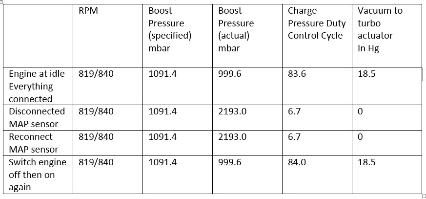

Looking in more detail I looked at Group 11 - Charge Pressure Control, while also looking at vacuum in line from solenoid valve block to turbo actuator. Gauge was connected with a 'T' so function of vacuum line should not be disturbed.
So as table below describes, ran at idle then disconnected MAP sensor then reconnected.
What struck me was that Boost pressure at idle is less than specified - aware that they will not always match perfectly but I presume this deviation is outwith normal limits.
Then although disconnecting MAP sensor changed CPDC, vacuum to turbo actuator and actual boost pressure, reconnecting MAP sensor made no difference to readings (stayed as they were when it was disconnected). Switching engine off then on again caused the readings to go back to almost exactly initial values.
I am thinking this is not quite right and hopeful there are some clues in here, but don't quite know what to make of it. Any ideas appreciated.
Thanks
VCDS RPM is not continuous - goes up in steps . Presume engine speed must have been right on boundary between these two values as it was alternating between 819 and 840

not sure why you'd expect any boost pressure at idle   I would be looking at temps sender and a sticky egr valve

Not so much that I had any particular expectation of what boost should be at idle - more just that I expected actual boost pressure to be a lot closer to specified boost pressure. Are you suggesting that the specified boost pressure of 1091.4 mbar points to an error? Anyone know what this could be indicative of?

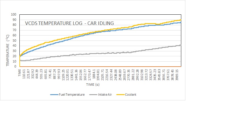

Plot of temp sensor output attached here seems OK. This one was done stationary at idle and took a long time to heat up, intake temperature did rise but that would have been due to no air flow. Did another temp. plot while driving - heated up faster and intake stayed close to ambient.
I would guess that your guage isn't that accurate/ or with in a margin of error @ approx 1/10 of a psi ( what range is it and when was it last caibrated?)   I can't see it being a problem,  re air temp it will go up rapidly once you start to raise pressure, bike pump effect
