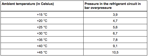

just out of interest does anyone know what the pressure should (approx/range) be in a non working IE ignition OFF system?
  • Sponsor
When I popped out to mine the other night 3hrs or so after its last trip, G65 was reading about 5.5 bar, I think, give or take. Highly temperature-dependent, I'd think. Ignition had to be on to make VCDS work, but engine was off.
Edited by Wino
thanks for that --- usefull
Yes it's temperature dependent and it can give you a rough idea of the charge in the system, see table below of where the pressure should be for corresponding ambient temperatures:
These are when the system is not running of course.
Read more: http://tinyurl.com/jdce5bp
Edited by Dazza95
