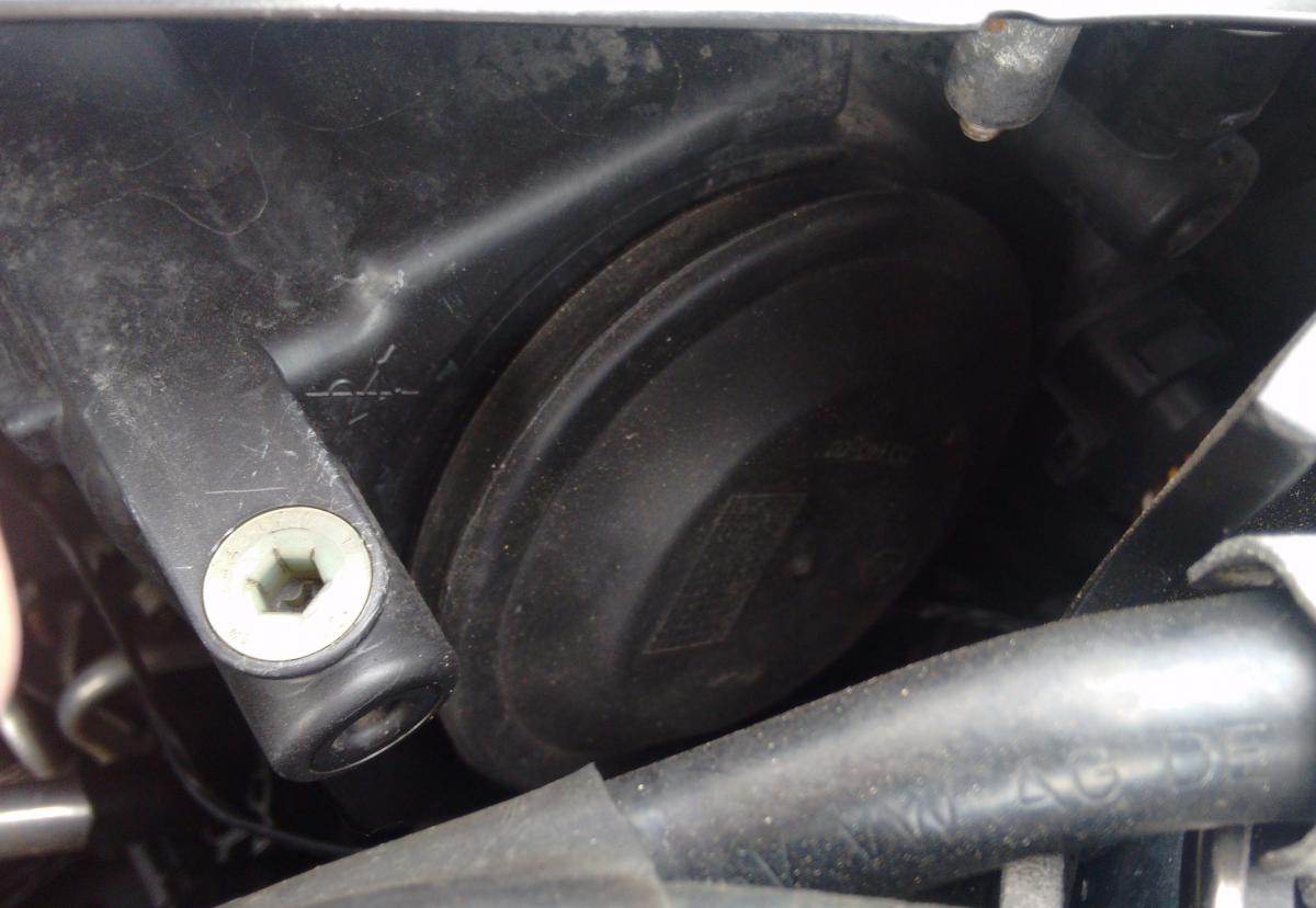

I've seen a lot about headlight aim affecting the pattern spread ... my headlights are aimed ridiculously low, I drove home on full beam last night and had not one single flash!
Is the allen bolt in the photo the correct one to turn?
Anyone know whether clockwise is higher or lower?
Mine has the simple reflector headlights but yet it was terrible when driving at night. I found out too that the beam was adjusted to the lowest position possible. What I did was to replace the factory fitted H4 (keep in mind that mine has reflectors) with Osram nightbreaker and ask my mechanic to raise the beam to the highest legal position using his light-beam adjuster-meter. That was the solution to my problem, without annoying the oncoming traffic.
