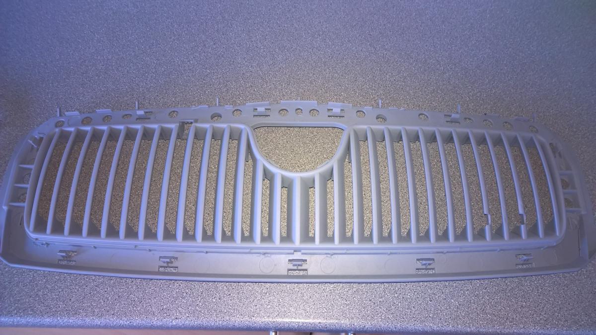

Took the grille out today, want it painting perfectly so removed the badge rather than mask it off.
Just dropped it off at the bodyshop to get painted satin black, will be ready to collect Friday :) hopefully I'll have stripped my spare headlights so they can be painted then also.
The badge put up abit of a fight but with the hair dryer on it for a while it pulled away.
No grille at all... Looks alright :D

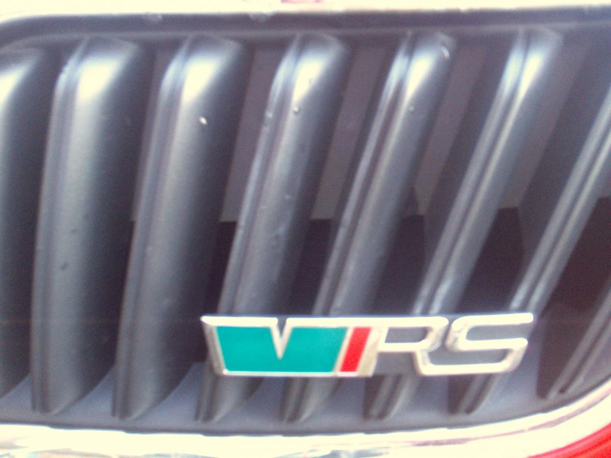

The grill has a black but shaped exactly like the badge but smaller so tha badge fits over it and just sticks on.

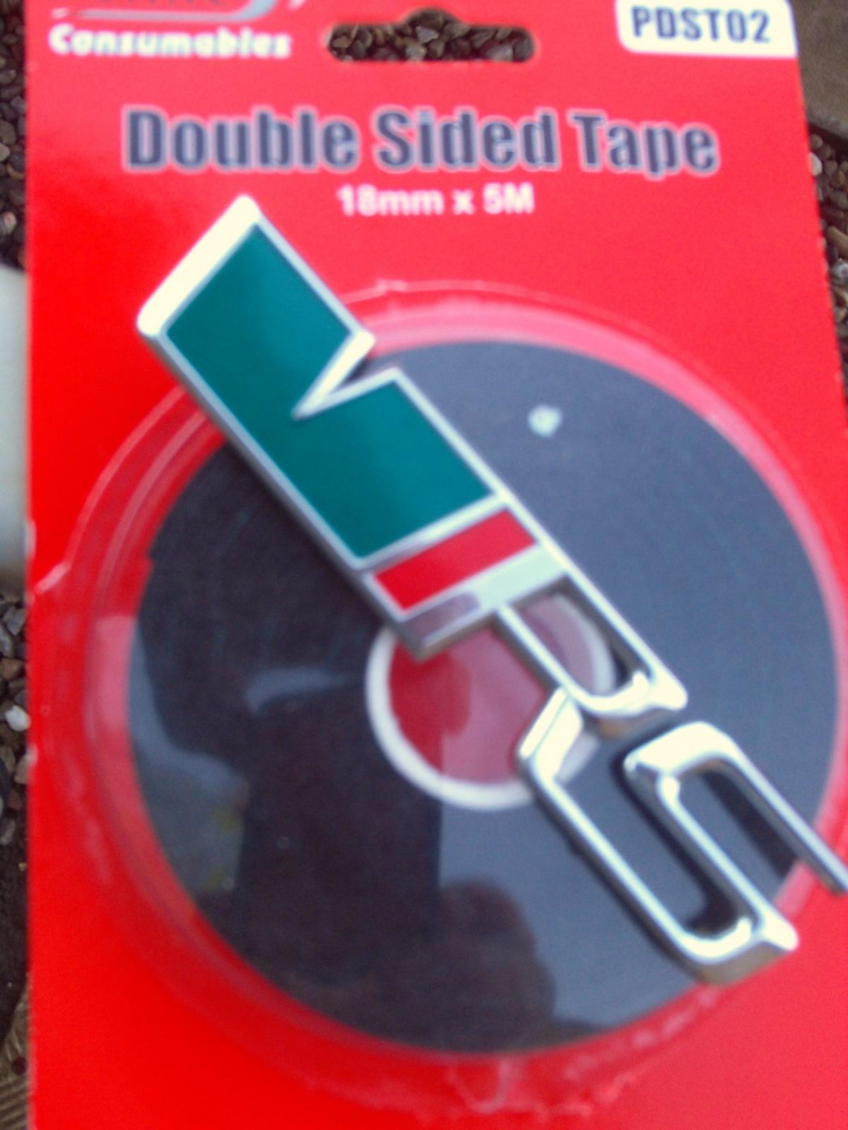

Replacement ones from Ebay etc sometimes come with 2 screws and a back plate.
Picture to left is the badge off the rear of a Mk2 which you could use with Double sided tape.
Picture to the right is a front badge which is different and can be glued on if you prepare the grill,
or use sikaflex, heat gun glue or trim tape type fixing.

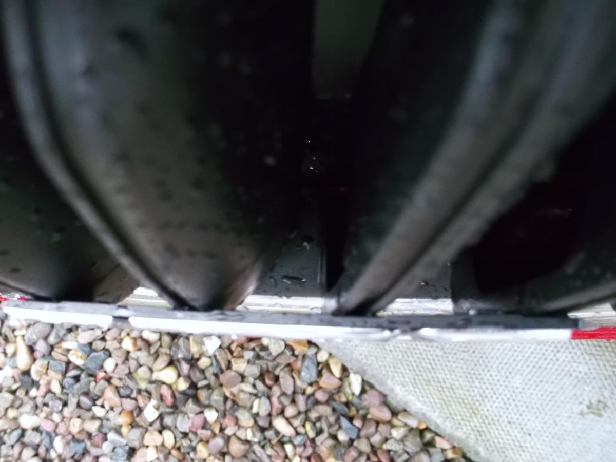

Mk1 vRS badge is glued on, but beware, the glue is very hard and you might damage the grill behind...i did.
If you want to fit one with the 2 pins out the back, you will need to trim the grill with a dremel as the angle of the slats do not let the pins go through correctly and the badge sits at an angle.
See slat 3 and 5 from the right for the bits needing cutting (i used a wire wheel on a dremel and it cut through like butter).
You could just use the rear badge as they are held on with tape.
