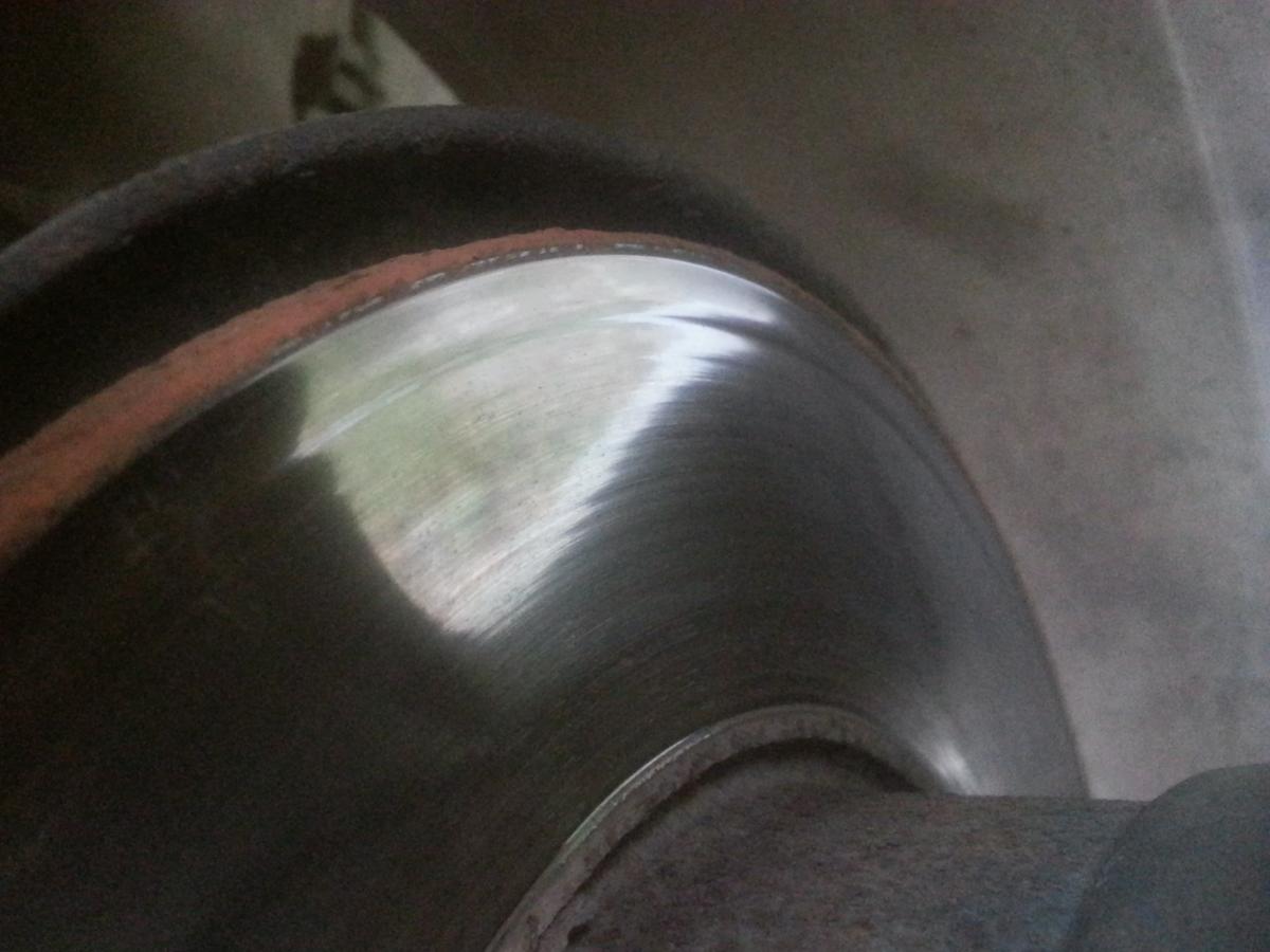

pads are almost 1 year old  in close inspection i think rear  discs are not in a good shape , what do you think

Not horrendously bad.
