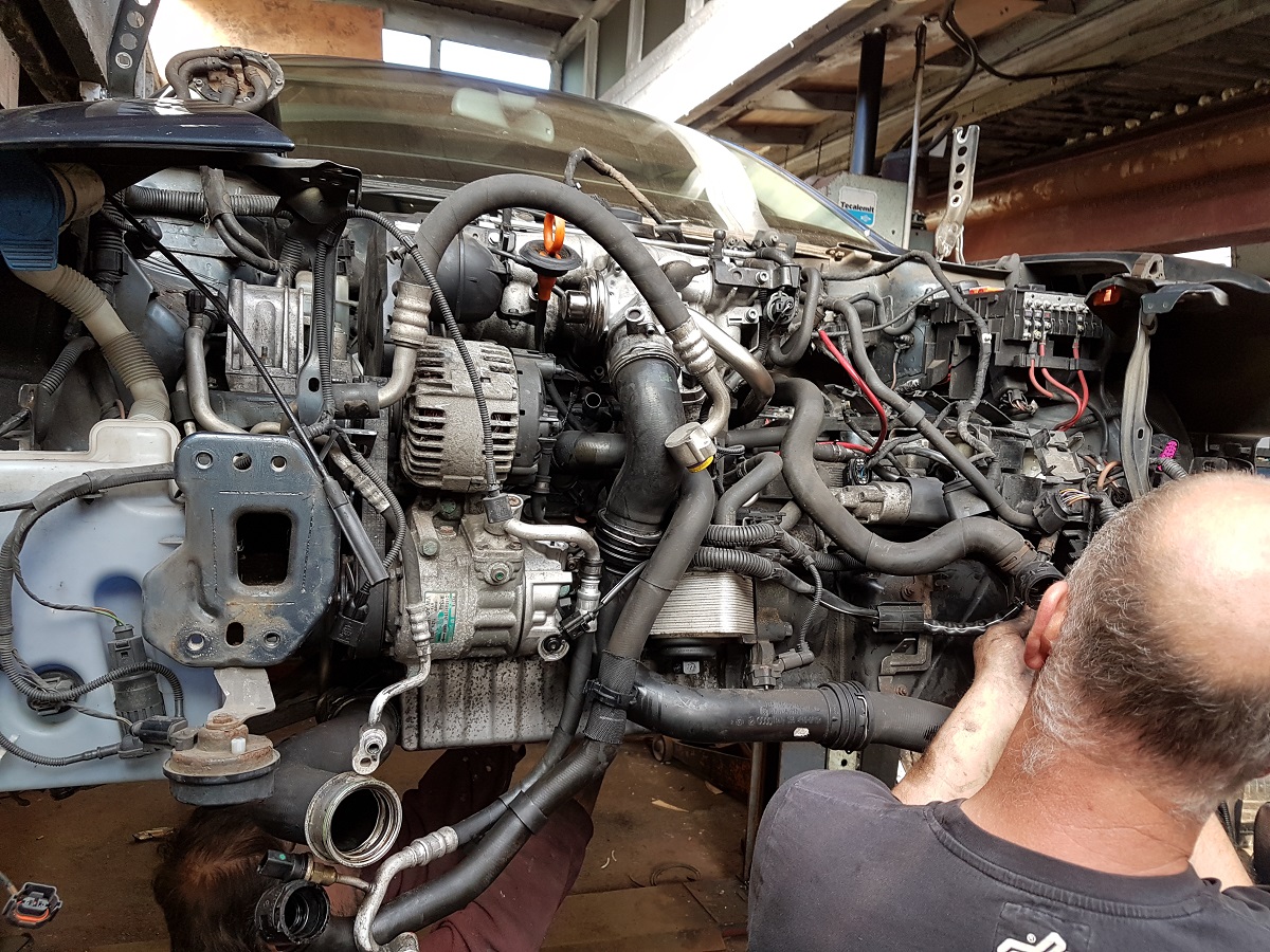

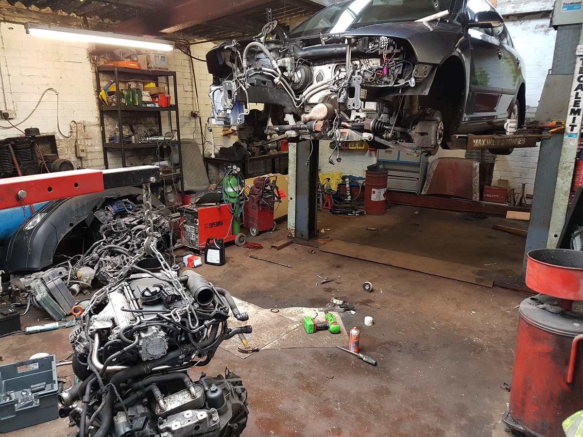

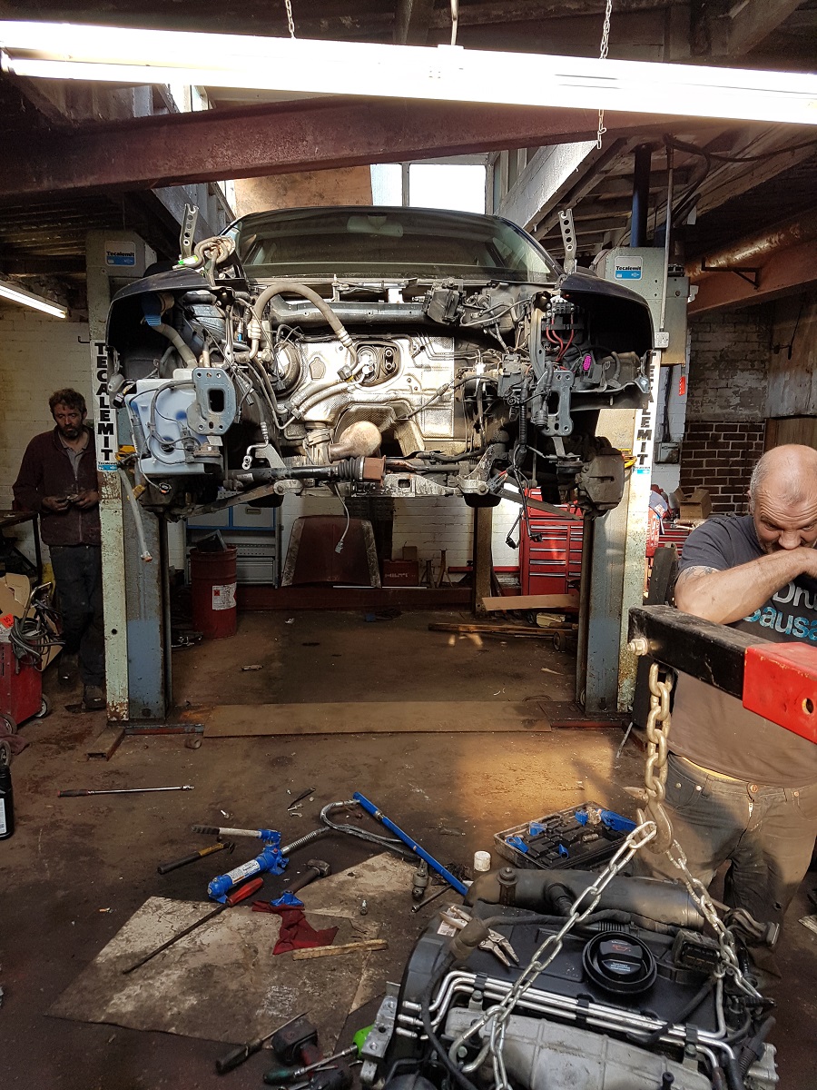

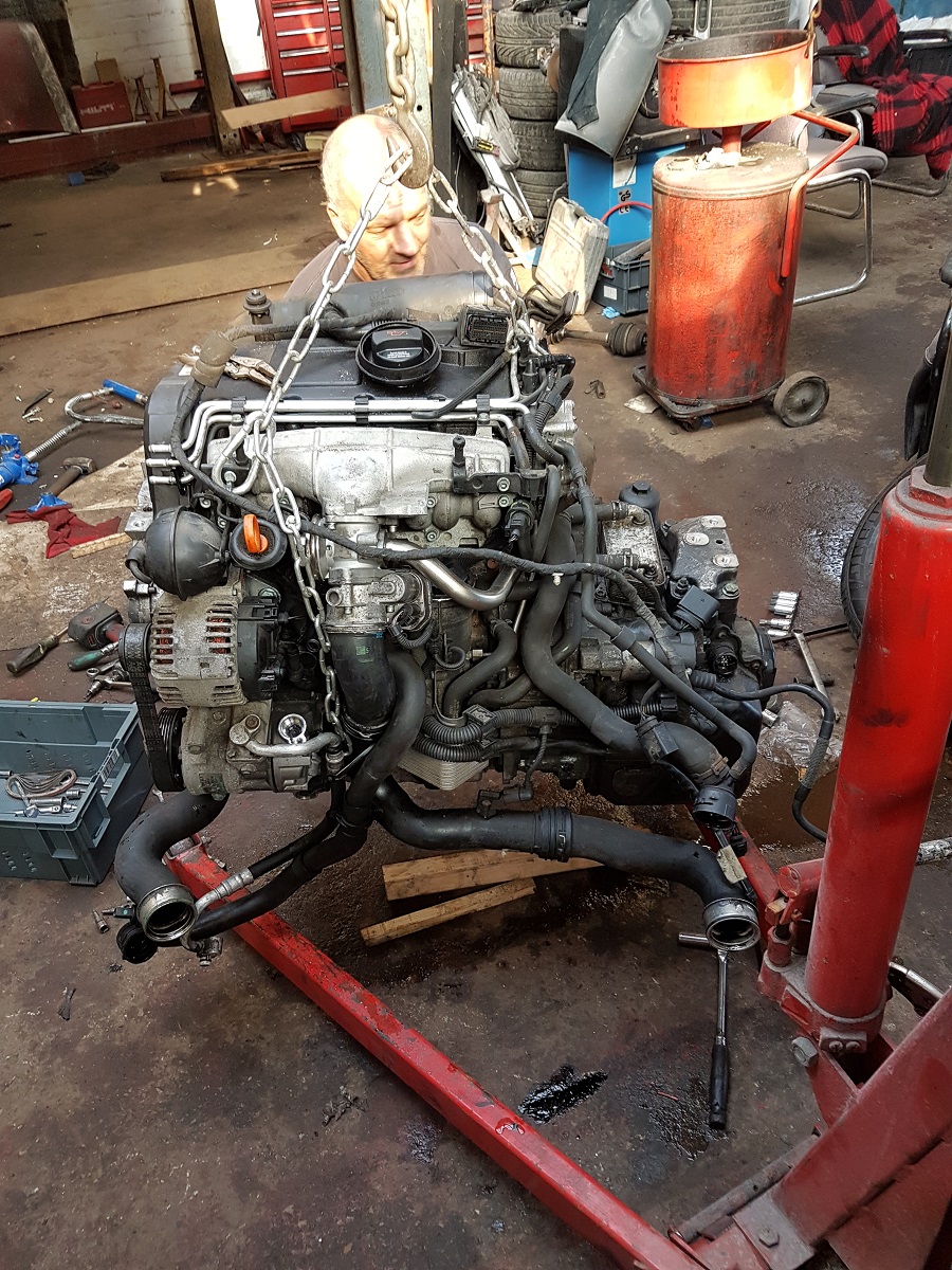

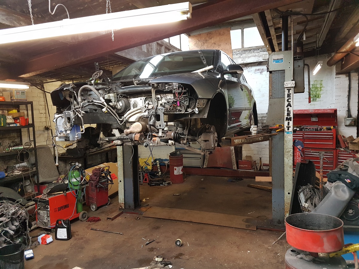

just an update guys
DMF in
new timing belt kit and plastic finned water pump (original VAG) in
the turbo was found to have some play and was allowing oil past so new turbo in
 so all in all its not that cheap a motor but on the other hand i know whats been done now
Edited by bmhill
been to have a look lol
was easier with the engine out apparently
Wow......that's a lot of disassembly for a flywheel, turbo and timing belt!
Good to see it's all coming together.
yeah i thought the same as well
the front bumper had to come off anyway because the washers won't work and there we found the mechanism broken so new ordered and he said that he finds it quicker and easier to get the engine and box out than mess around with the gearbox and then mess around doing the water pump and timing belt kit and also with the turbo being suspect he opted to take the lot out and the rear engine mountings were perished
new gearbox oil has sorted the juddering and harsh gear change 95%
i have not had the shudder since and had only 1 or 2 clunks in the past few days
i just need the adaptations setting in the gearbox via vcds and then i will know what is what
