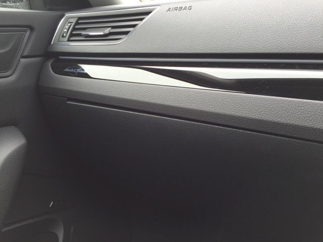

3. Finally, has anyone else had an issue where their glovebox isn't quite flush when shut?  Picture attached.  If it's normal, then fine, otherwise a trip to the dealer.

3. Some owners may have had this issue, but I haven't.

I had my glovebox replaced last week because of poor fit and the fact it rattled like a bast....
All is silent again.
I have had my glovebox lid adjusted due to poor fit similar to your picture. It is not perfect in my opinion it is due to the latch design.

I have the same issue with the glovebox on my Superb & wife's Octavia. Definitely a design flaw/quality issue
