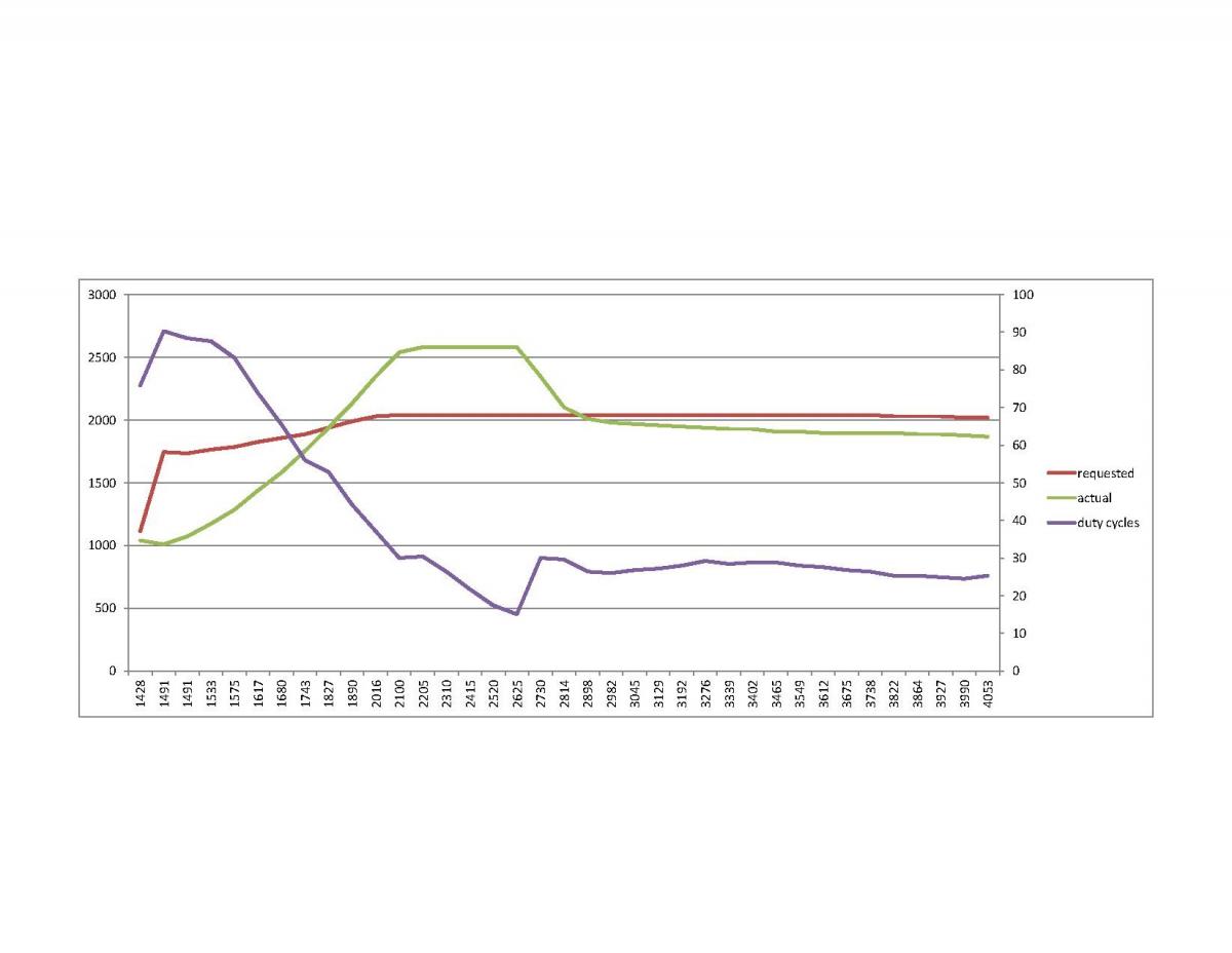

OK, apologies for delay, hoping this file has attached and gives the necessary info thanks
group11 log.csv
As you can see from the graph below, your turbo isn't working as it should, small overboost would be fine but 500mbar is too much. Mr. Muscle treatment won't have any effect on this. Do you know if the turbo is still original one or if previous owner replaced it?
I am pretty confident that it is the original turbo, I believe it has been like this since I bought it two years ago, forgive my ignorance, I take it the graph shows initial under boost, followed by over boost. Would the over boost probably cause the slight stutter as it backs off?? May it also explain why the re map had little effect?? I am surprised that nothing came up when the re map was done but i can discuss that with the lad that did it. What would you suggest is at fault and where should I go from here?? It runs okay, but I would prefer it to run better if possible!! Many thanks for your help
On the graph, the red line represents amount of boost which ecu requests from the turbo, the green one is actual pressure read from the map sensor and blue one represents amount of vacuum applied by n75 valve.
The "underboost" at the start of graph is normal because the turbo doesn't have enough exhaust fumes and spools up as rpm rise. Your concern is the overboost. If the turbo is original, then it should be set right and problem could be with n75 or vacuum lines.

Thanks for that, according to service book the fuel filter got done July 2012 at 56k, now done 91k. That was before I bought it, and if that is not correct in the service book then it has never had one. When the lap top was on it, the injector readings appeared to be very good and even across all four, I could start by getting the fuel filter changed just in case then take it to a specialist to work out why it is over boosting.

Showed the graph with the overboost, been told this is probably due to the stage 1 remap that was done, and therefore the issue is with the map. I don't really understand that. If the map changes the turbo boost in some way, and there is a bit of overboost, should I be getting better performance, more power etc???
