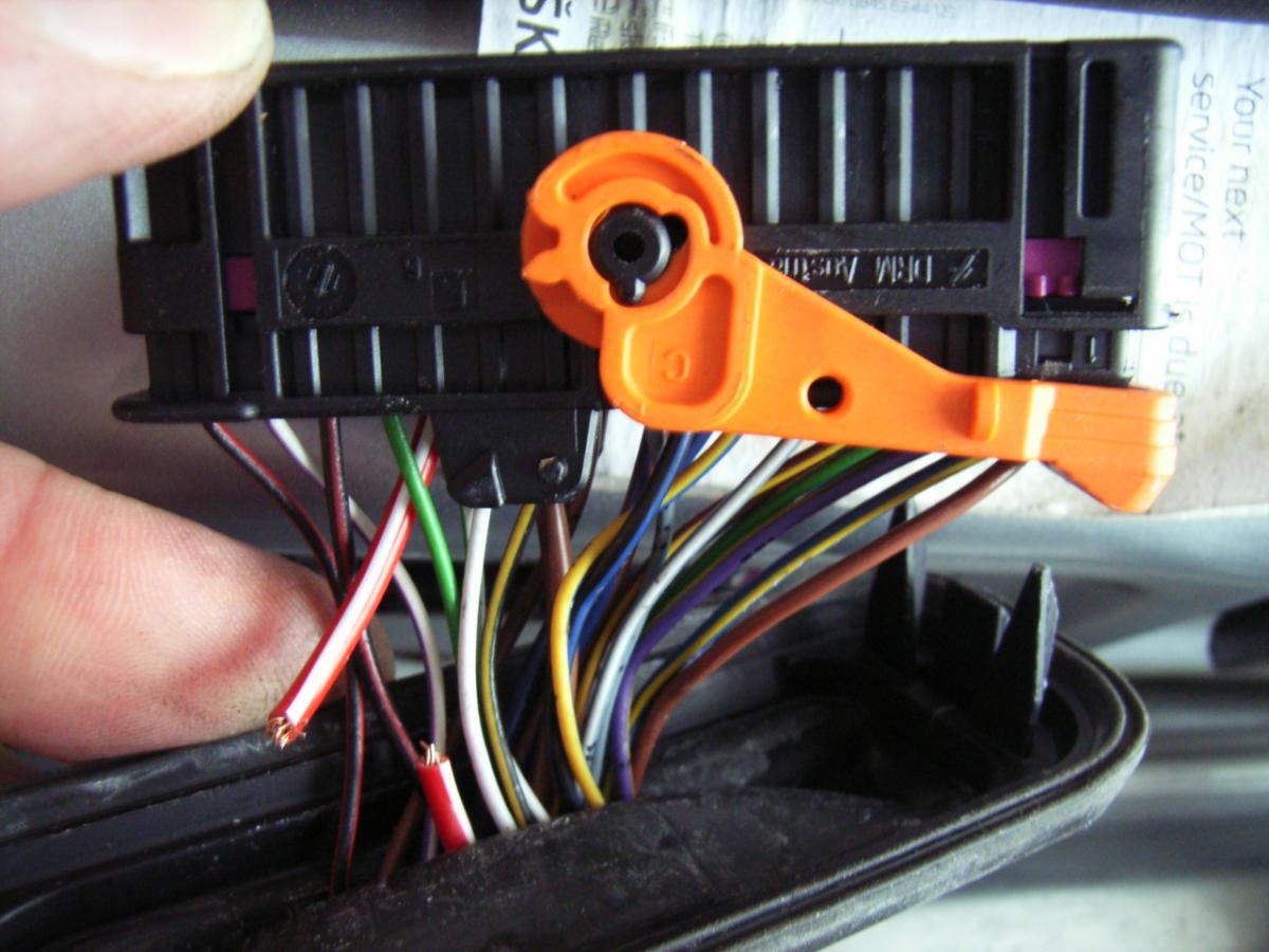

Sorted !!!
Following another thread I pulled off the cover and the red/white wire was fractured. I have added in about 40mm of wire and sleeved the joints.
It seems this wire is or over time gets pulled tight.
Once the connector was refitted the standard process of fully lowing the window, releasing then holding the switch, fully raising the window then releasing then holding the switch reset the one toch and it stayed active after removing the key, opening and closing the door then inserting the key.
Similarly raising and lowering from the fob works again.
The car has only 38k on the clock, I don't do lots of short journeys so opening the door many times a day nor normally open the door fully.
