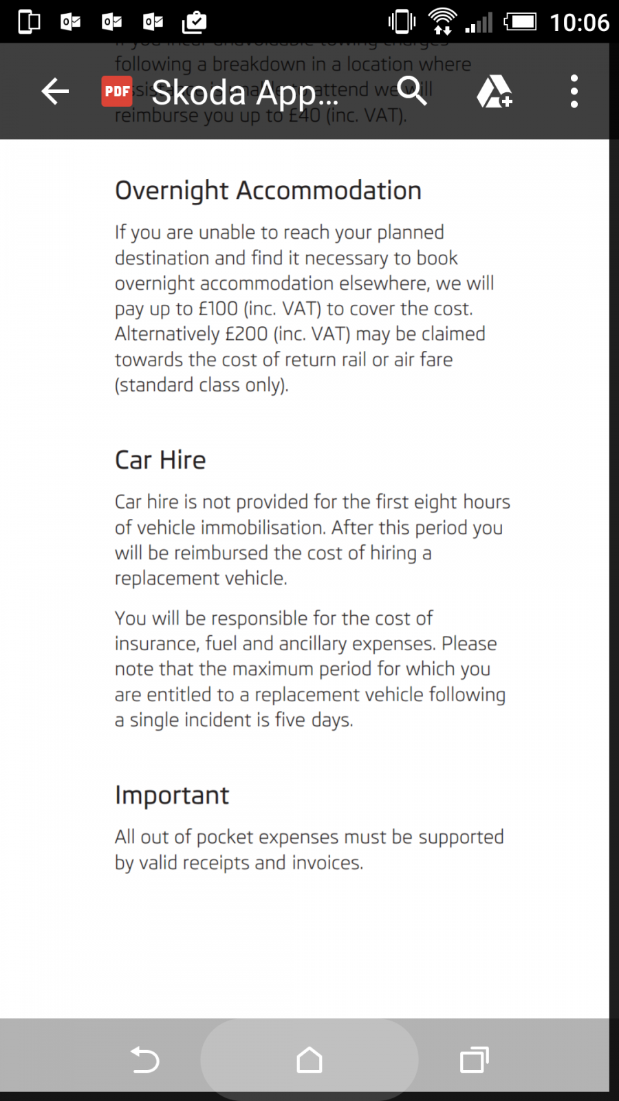

Ok, so westover are saying there is defiance damage to the cams and they're still investigating it further as the fault codes gave back a ten page job list. They said it may just be a head replacement, I don't want that. Am I within my rights to push for a new engine?
The noise you heard we're the pistons hitting the valves, so, when mine let go, all the valves we bent and the head was scored. Its very unlikely just a head as what he the head will be damaged etc. etc... I would really be pushing for your money back as it sounds like the engine is totalled. But, turners may want the car back.

Basically, it stops you hiring a car if yours has a minor fault that can be rectified in a day.
