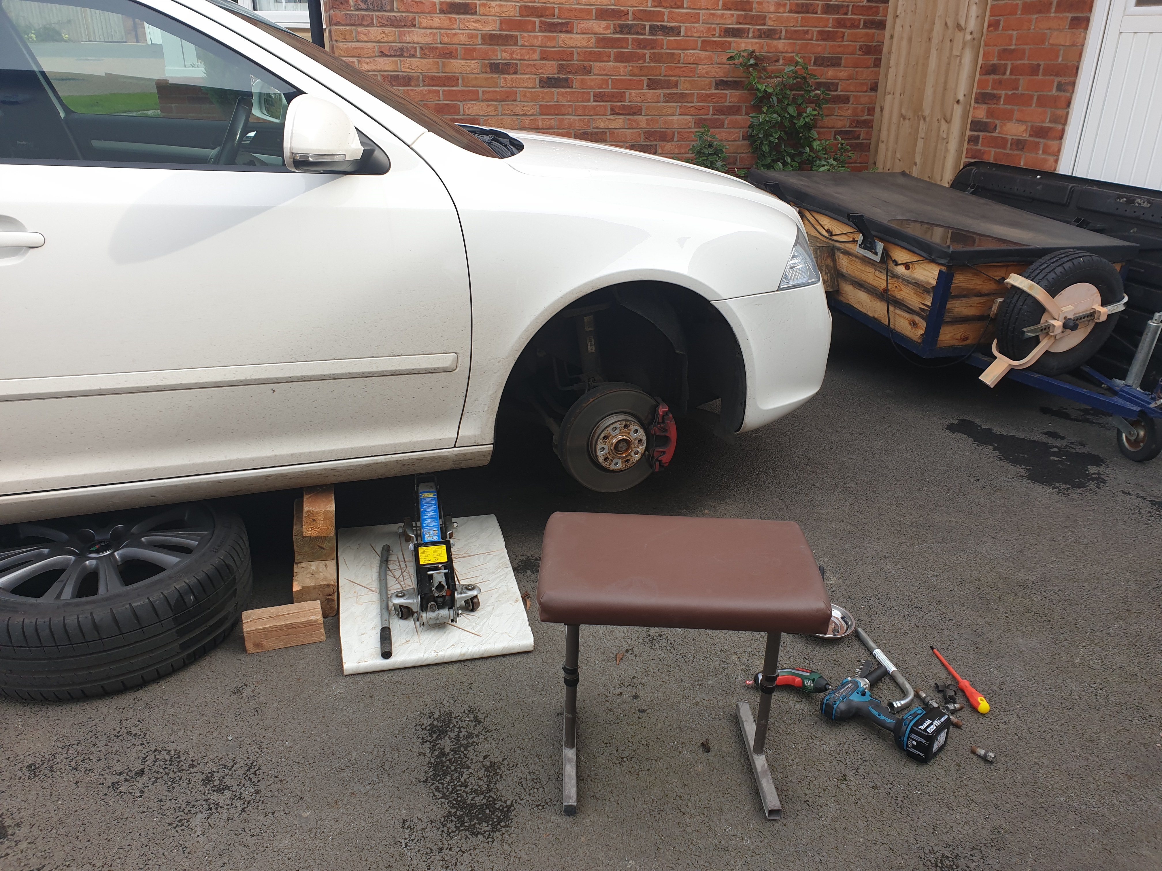

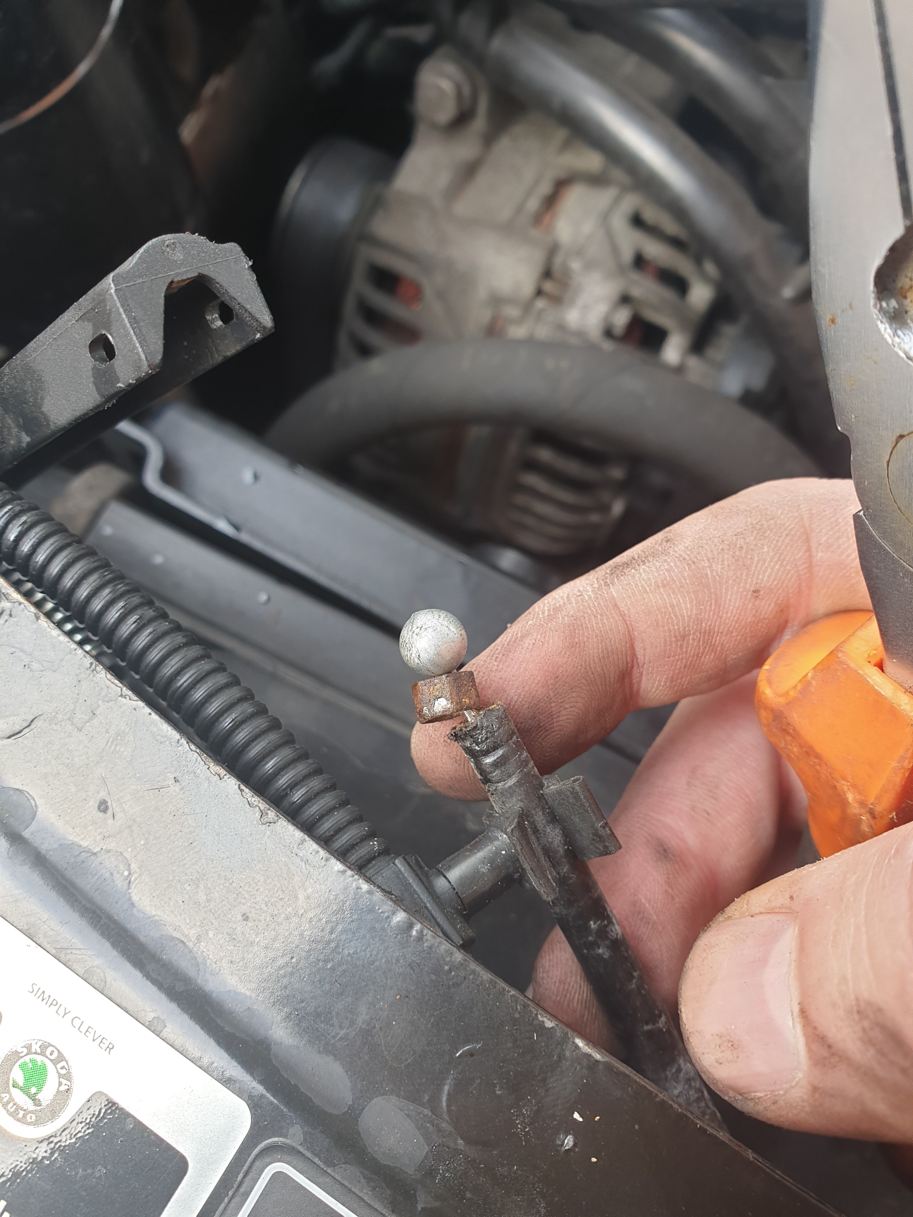

Sorry to resurrect an old thread but many thanks tech1e for this advice.
Managed to open my bonnet today after over extending my handle which popped the metal sleeve off the cable in the bowden connector.
Time to get some axle stands on your Christmas list 😂
