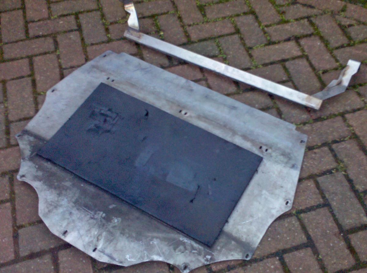

We had some made up for the Mk1 Fabia, but this was some time ago!
In principle, take the plastic engine tray to a metal fabricator, use the original plastic version as a template and have something made up in suitable thickness stainless steel. With a reinforcement bar, to distribute the extra weight, compared with the standard plastic offering.
This is what the Mk1 Fabia one looked like - came in very handy! As that was known for having quite a vulnerable sump, as a few members on here will attest to!
I have an original.
It is a much larger part and you need 2 metal arms and different bolts.
