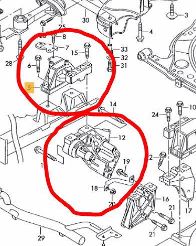

Circled parts are the RH mounts, so more than 1 bolt. When was the timing belt last changed? possible that whoever did it didn't torque the bolts correctly
Or didn't change the bolts at all - they are stretch bolts and in theory only be used once
