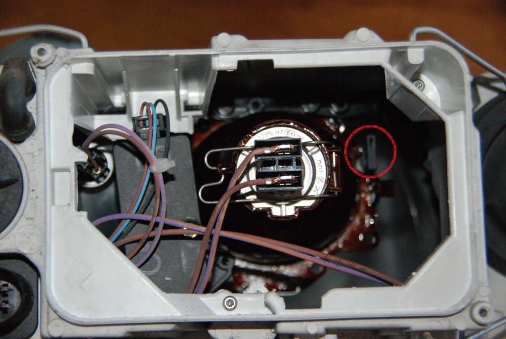

What do I adjust inside the light to flatten the beam pattern for driving abroad?

Use a small flat screwdriver and move the lever in circle a bit to the right. It doesn't move much, just about 4-5mm but you should feel when it's done. Some on the other headlamp but the lever will move other way.
That's what I wanted to know!!   Many thanks.
