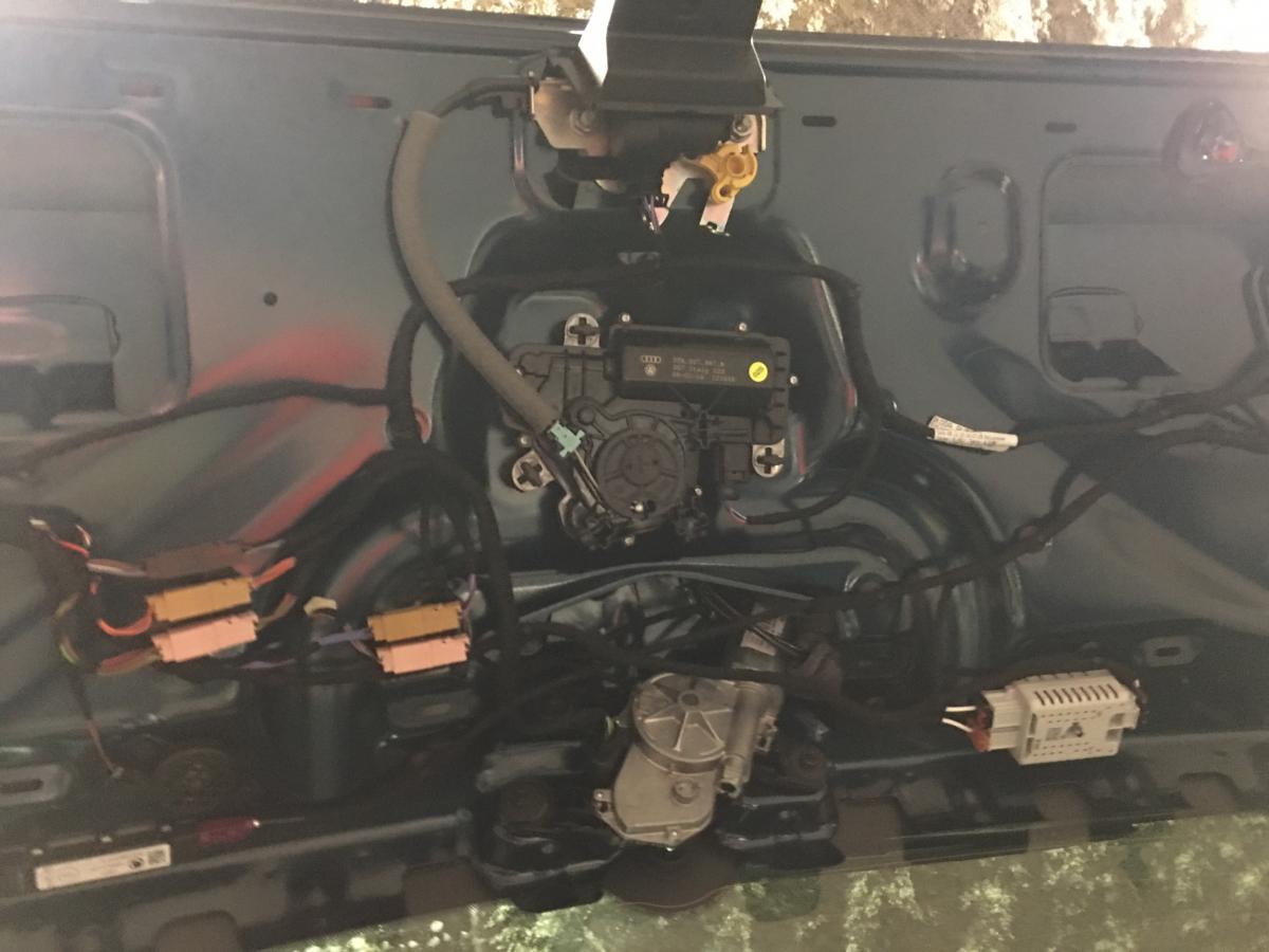

My rear camera is fed from the main unit that's stuck to the windscreen. Running the cable from there to the tailgate was an utter PITA. I had to be very careful routing the cable so as not to interfere with the curtain airbags, and their potential deployment.
There's plenty going on in the tailgate as well!

With my camera (Thinkware F770) the power is sent to the main unit at the front. This is via a Powermagic Pro that allows the camera to run even when the ignition is off. If the car's voltage drops below x volts (adjustable via DIP switches), the camera is shut off.
The rear camera takes its power supply from the the main unit via a USB cable, video is also sent back to the main unit via this cable. Because of this design, I had no choice but to run the cable from the main unit on the windscreen, all the way through the car and into the tailgate.
Yes, it was a horrible job, but the whole thing took around 2 hours to complete, and the end result is a neat install with no more than 2 inches of cable visible at the main unit. The worst parts were of course the rubber cable ducts between the chassis and tailgate, and routing the power supply to the fuse board behind the glovebox. The Mk2's fuse box was behind the light switch and was therefore a doddle to route down the A pillar and straight onto the fuses.
I looked at a twin front and rear camera set up, rather than the dual system I currently have. The position of the rear camera when stuck on the tailgate glass means its in my line of sight when I look in the rear view mirror. Secondary cameras are always much smaller than the main units as they don't have to incorporate GPS, SD cards, power management, microphones etc etc. A main camera stuck to the rear glass would be too bulky for my taste.

Just be careful with the electric tailgate. I triggered it a few times when struggling with the tailgate inner trim replacement. Pulling on it no doubt triggered it to close. Trouble is, there was no button fitted at the time to stop it from closing on me, as I was sitting on the boot lip at the time.
Maybe consider pulling the fuse for it or disconnecting the battery.
