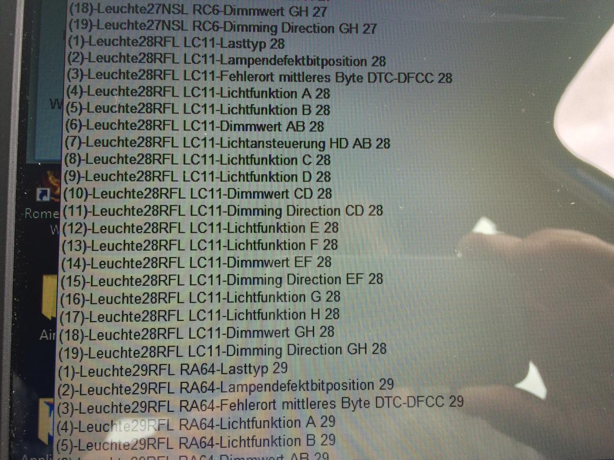

I have just upgraded my reversing lights to these:
http://www.aliexpress.com/item/HotSale-2pcs-lot-super-brightness-High-Power-1156-led-30W-CREE-XBD-p21w-led-ba15s-Reverse/2036956876.html
Reading on a previous post aki78 advised that these are the channels for the reversing lights that need to be changed to LED
By the way the two channels for the reverse lights are:
-Leuchte28RFL LC11
-Leuchte29RFL RA64
However upon looking at the channels there are 19 listed under each one
Which one for each channel do i change to LED?

Change the 'Lasttyp' channels. Not absolutely necessary, those bulbs will work without any coding.
