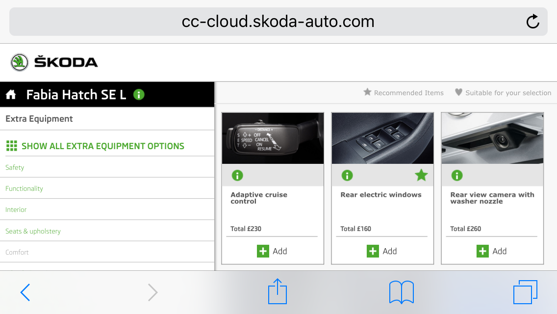

Does anybody know if the Adaptive cruise control can be retrofitted on an early 2015 Fabia? I have the front collission warning radar (and standard cruise control with limiter)  already.

I went for standard cruise control (ACC wasn't yet an option at my point of order) and it does tell me when I'm too close to the car in front, so I'm sure the technology isn't far off ACC with the radar etc. Would be interested to know if it can be retrofitted. I do mostly motorway miles - 500 per week.
Have you got the radar unit in the front grill? Or just the standard proximity sensors in the bumper?
Never come across a VAG car with Radar but not ACC
Either way retro fitting ACC would be generally cost prohibitive.

Yes I have. Don't have proximity sensors on the front. It's got the city braking feature.
Ok, got it now.
Seems odd that they give city braking, but not full ACC. Suppose a way of extracting more cash from the options list!
In that case it might be easier if most of the hardware is there :)
The ESP unit is different. The simpler with front assist can only do emergency braking, the ACC unit can adjust the brake force too.
