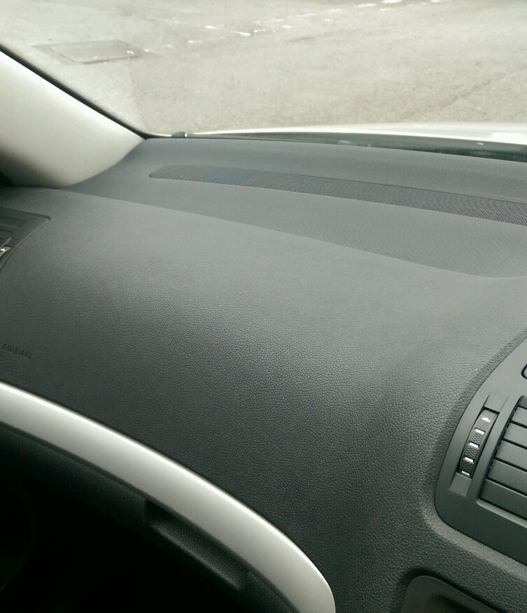

Has anyone got a suggestion of how to find or diagnose this very annoying rattle which sounds like a loose flap virbrating, it's emanating from above the glove box and behind the passenger airbag. I've had the glove box off for a week and been poking around to no avail, is it a dash out job or can I remove something off the top like the mesh grill etc???
It's eating me alive ahh, cheers.

It's coming from behind the passenger air bag around the pollen filter but I've had that out and cleaned it. I've checked most things in the same vicinity but nothing is loose, very annoying and I can't ignore it.

Remember reading some where about the silver trim vibrating just above the glovebox.
