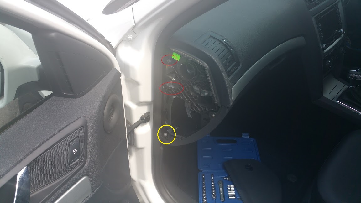

See pic below. On removing the end panel of the dashboard, applying a very small amount of pressure (literally a finger touch) to the bit of plastic in the bottom red ring produced the squeak - so I can only assume the natural motion of the car did just this when travelling along. The solution was to simply slacken the screw shown in the top red ring by a couple of turns - still perfectly secure, just less tight, and now no squeak. Bliss.
That one, and the one at the bottom (not circled) were the ones that I copper greased, suggesting that your source is/was the same as mine. Might slacken it off half a turn or so.
I did try covering it and the washer in silicon lubricant first, but having re-tightened it up the squeak was exactly the same - so I'm not convinced the squeak was coming from the screw/washer itself, but was a consequence of the tightness meaning some other area of that whole interconnected plastic structure was complaining.

I've just done mine coincidentally and think I've managed to fix the rattle/squeak :)
The bolt highlighted in the yellow was loose, not even finger tight. I ended up taking the glovebox out completely (5x screws iirc - 2 on the side behind the panel, 3 on the top inside the glovebox) as I struggled to get to the culprit, even with a flexi extension :(
I used sprung (I've always called them this, but google seems to call them split ring?) washers on each of the screws and this bolt and it seems to be cured. Fingers crossed.
I've tightened the side 2 up before, but it seemed to only be a temp fix - hope this lasts longer.
