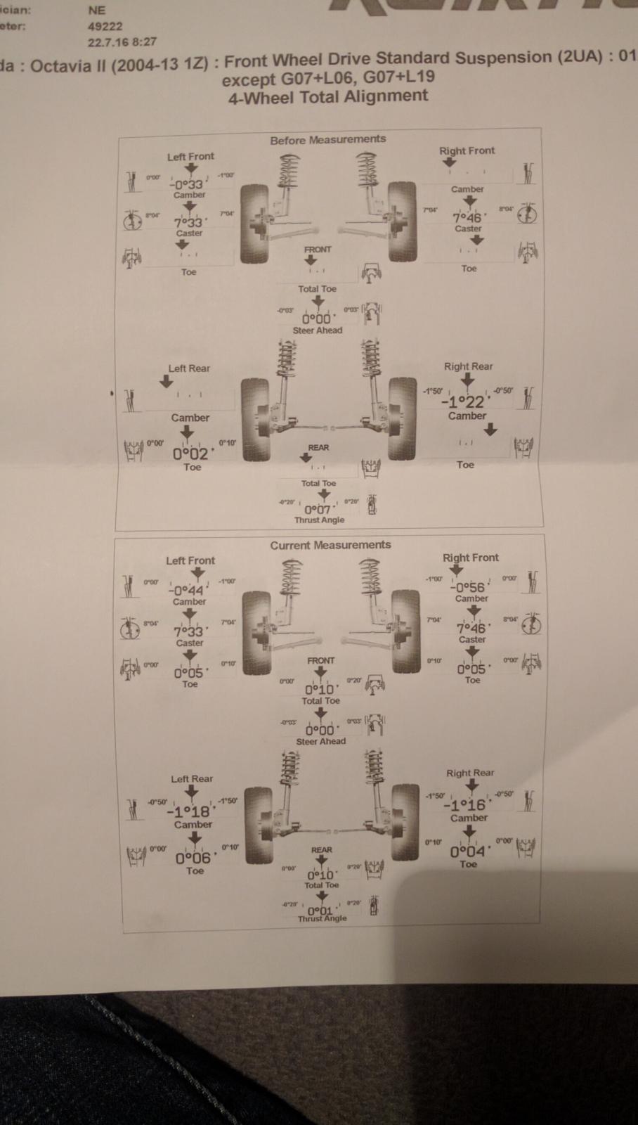

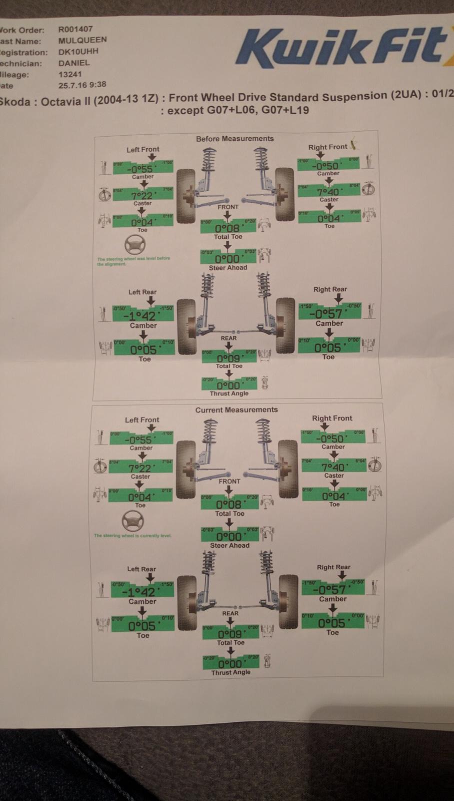

Here are the two alignment print outs for Kwikfit. The black and white is the first Kwikfit I went to, the colour is the second. I've noticed there is some differences between the two considering I went from one to the other in 20 minutes. I though all in the green.
Does anyone know if front camber can be adjusted and how?
