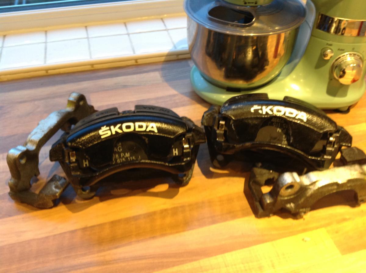

I've got Callipers, carriers and pads in mint condition that would fit perfectly, in the for sale section and open to offers.post-120571-0-97741100-1470847822_thumb.jpeg
