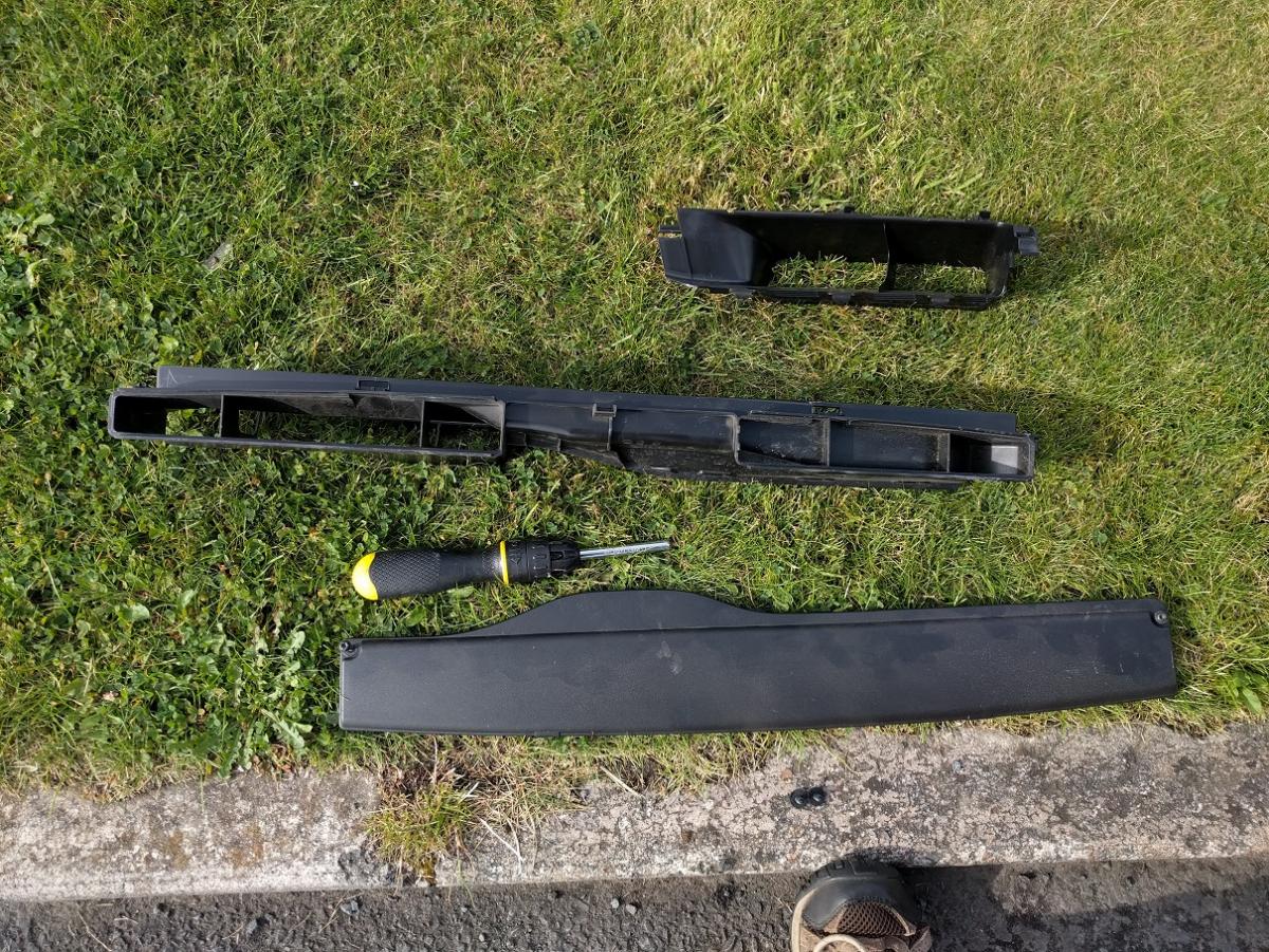

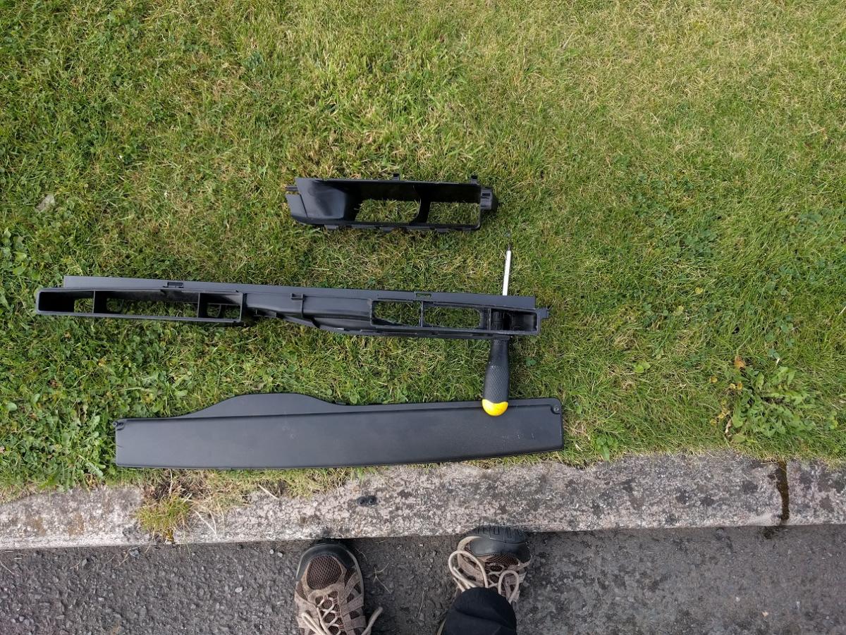

Airbox Mods
Removed baffle plating inside the air box
023CE565-39B4-429B-8744-8A44F751CBDE_zps​
The front duct is not designed solely for performance, by also for emission regs / noise etc.
It only can draw air in from the R/H side, the L/H side (where the airbox is) is completely blocked.
This mod involved cutting out the scoop to allow air through, and blocking the other side up (where is passes directly through to the engine bay).
This mod is well documented on the Golf MK7 forums.  We actually get it a little better than the golf as the bonnet obscures more of the intake on the mk7 :-)

next question - how do you get the front duct out to mod it?

This looks interesting! Only issue I can see is postage from the US, and also reading pages 6&7 of the thread it looks like the ECU opens the DV at certain points to regulate the boost pressure causing an air leak noise to be heard.
To get the front duct out there are 2 torx bits to remove at either end, you will then need to pull up the airbag out of its rubber lugs to get enough clearance to get it out.  Its quite easy and the Mod ensures cold air only and a better flow.

just finished doing this - opened up the airflow to the box (drilled through the plastic then filed it down) and also removed the ?snow catcher inside the airbox. it is a bit fiddly to get the front intake out but doable. be careful putting it back together as i managed to drop the screws twice!! into the engine bay when try to resecure it (found one ok, 2nd one required jacking up one side of car and thumping the undertray to move it somewhere visible
i certainly notice a quicker pickup today driving especially from low speed
