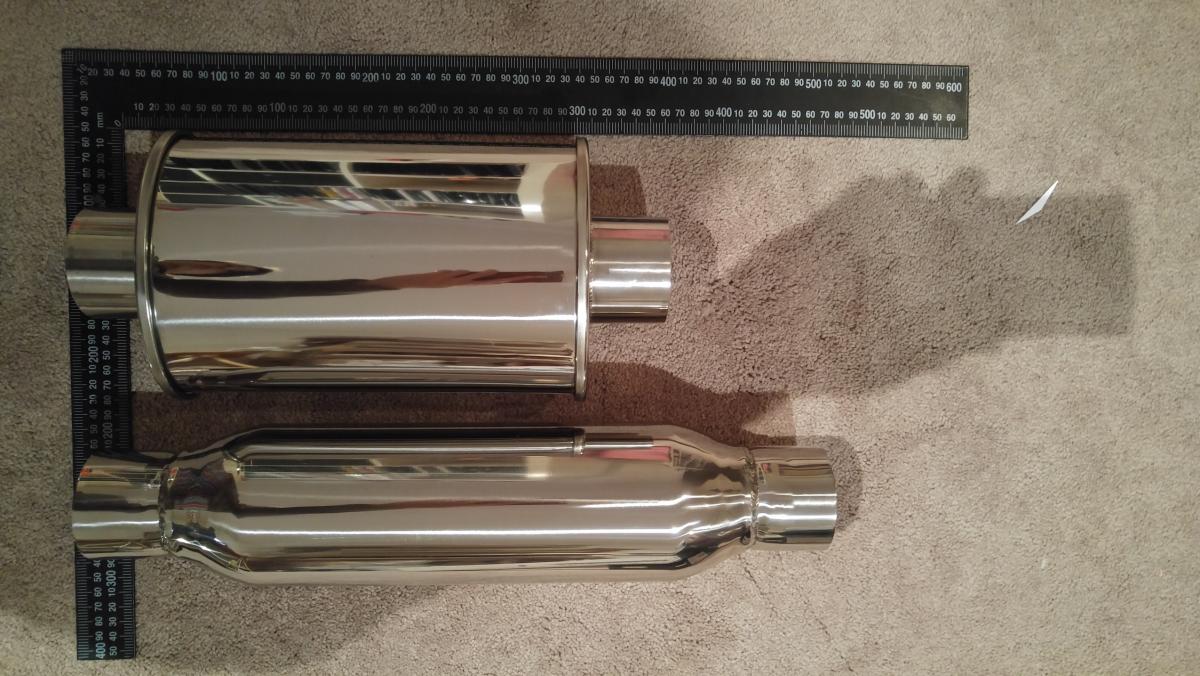

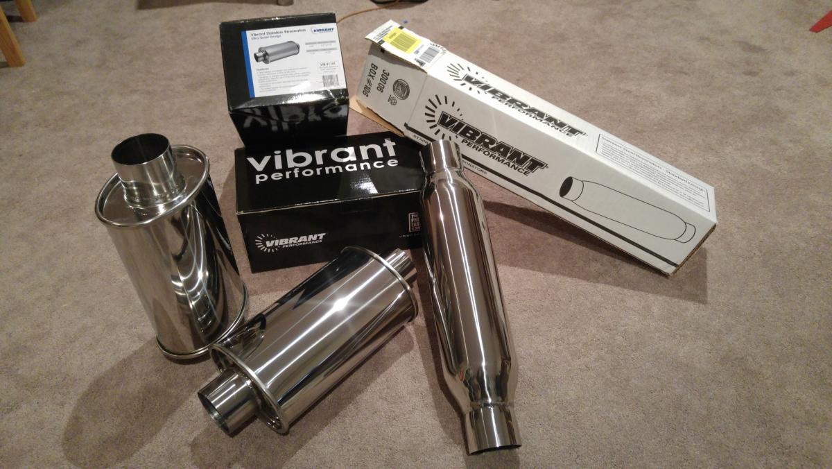

Here's some actual picture of the resonator, quality is excellent (nice weld and finish) for the price you pay. They are rather heavy and solid.
The fatter one is the ultra quiet model, I'm planning to fabricate those to replace the rear muffler.

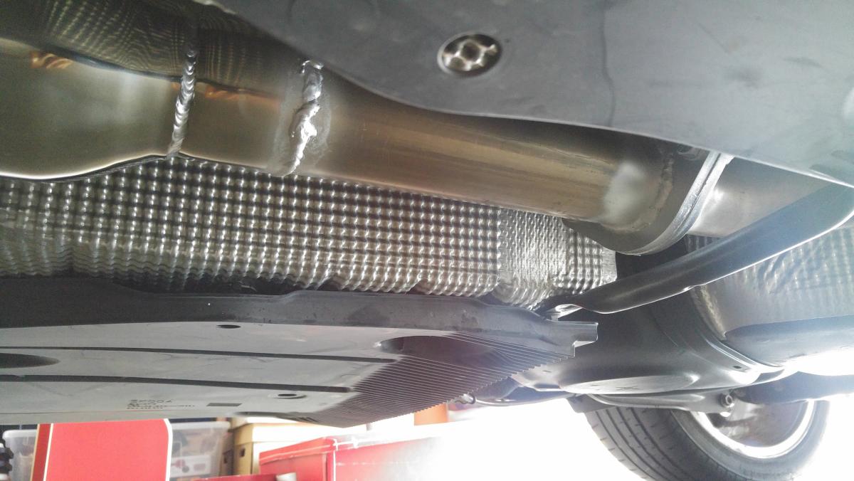

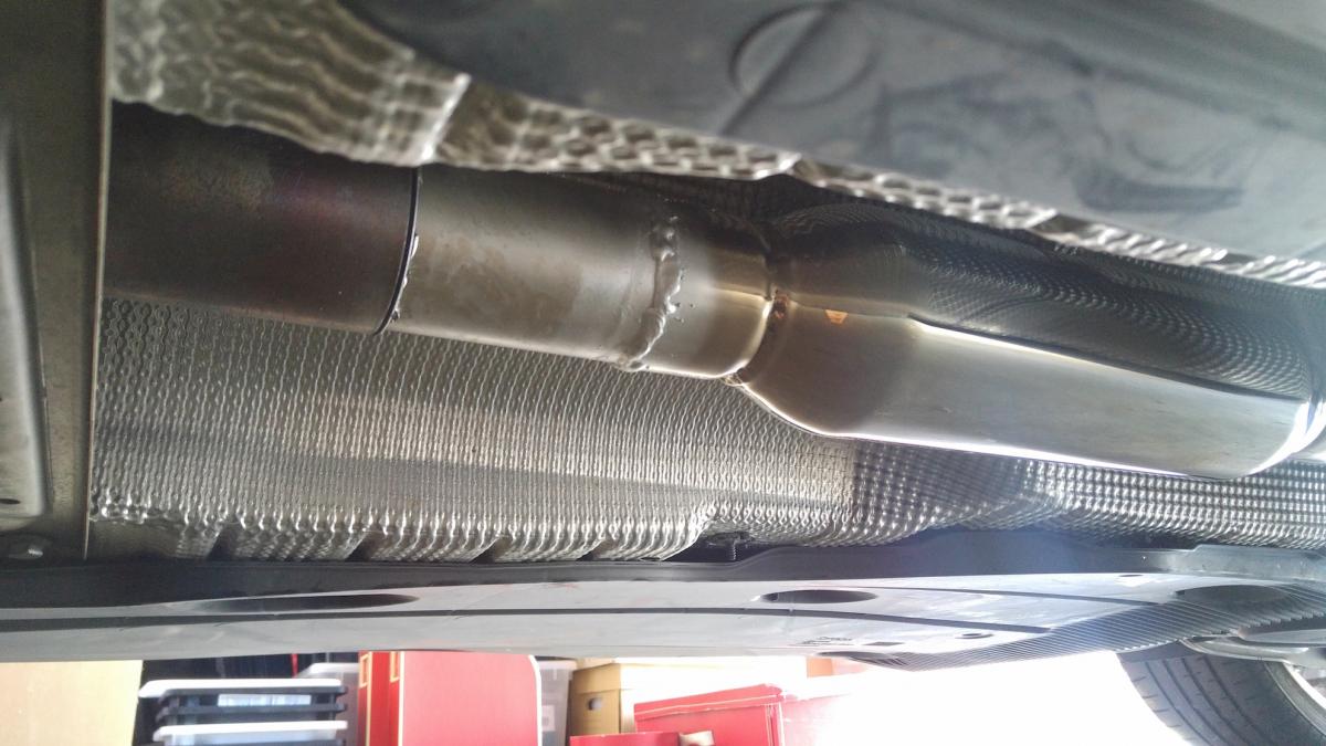

This is how the current resonator sit on the car, as my exhaust is one solid piece, we fabricated flanges toward the back, so it can be easily removed or swap with different resonator if needed.
My observation so far regarding the resonator (2 weeks in, about 500km), it definitely changes the exhaust tone straight out of the box, deeper and meatier, you will notice it during cold start. Keeping the RPM under 2k, it will be hard to tell that anything has been changed, a good thing as highway cruising is just below 2k rpm (in my case anyway).
The heavier the throttle is apply the louder it gets. Driven aggresively, the noise is IMO spot on, it never overpower the engine sound and retains the urgency noise of the engine which I like. The car does DSG pop now, not all the time, only when driven hard.
There is however a specific resonance point around at around about 2.5k rpm at certain throttle position. This seems to mostly happen if the engine is being lug (laboured) which is probably not the best thing for a turbocharged equipped engine anyway. Note though I didn't have this resonance with a cheaper glass-packed resonator, perhaps due to the damping properties of fibreglass.
