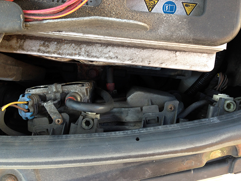

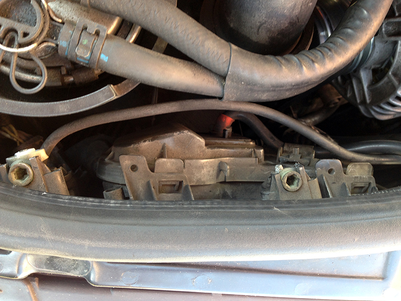

Maybe some photos would help?
Normal functioning passenger light
Non adjustable drivers light
From a different angle
You need to take the headlight off the car and remove the back cover to see the adjuster. It is inside the headlight.
Chances are the adjuster has come off, and simple needs clipping back on.

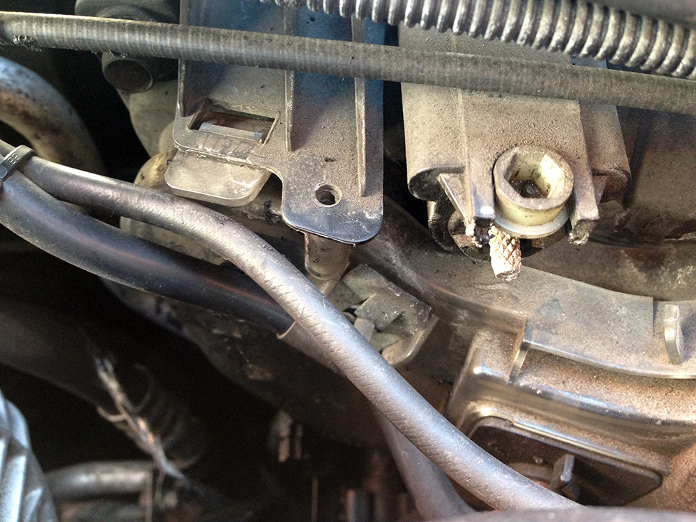

So I followed your advice and attempted to align the right with a set of pliers.
I can adjust the light to the correct level, but as soon as I let go it falls back out of alignment. I think theres a screw/dial thing missing :(
Any ideas?
I see from the photos that the screw/dial is missing, but I don't understand why it falls back out of alignment when you let go.
In the 3rd photo, the peg that sticks out from the headlight (of which the little dial should fit onto) should rotate, but friction should keep it in its position to prevent it spinning. That's the bit that's stumped me i'm afraid....

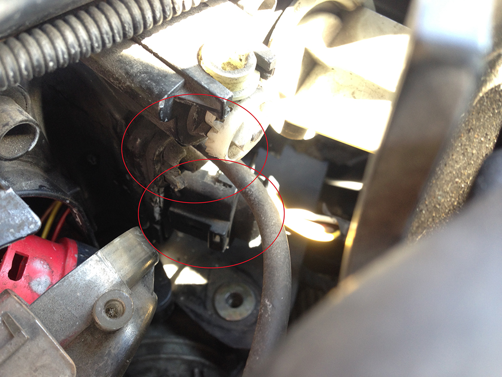

So I'm in the process of attempting to take the Xenon headlamp out, anyone help me with the wiring?
Struggle to disconnect the wiring circled in the photo...
Top one you've circled stays put (the depo units have there own plug adapter that will plug into the ballast unit)
The bottom one does require to be unplugged, but can be a bit of pain.... Just requires a very firm press with your thumb to lift the retaining clip, and a bit of a wiggle. You might loose some sensation in the your thumb, but it should come off ;)
